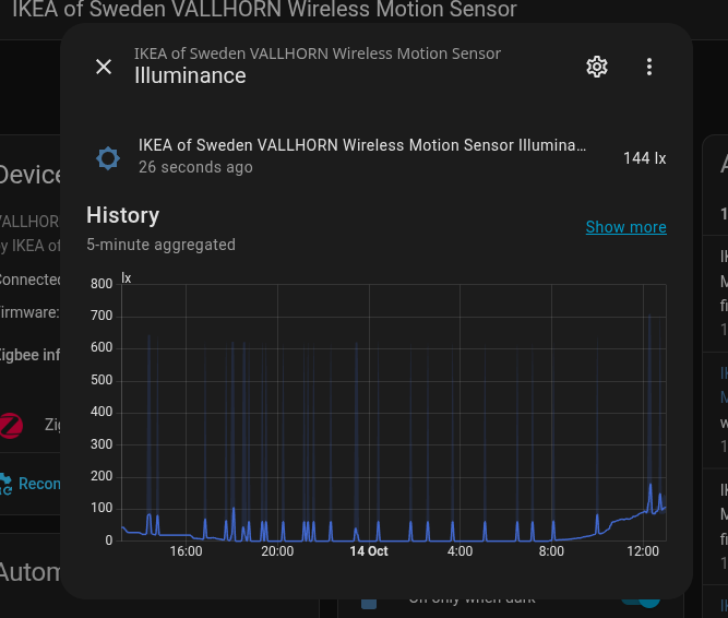

Hi all,
Does anyone have an idea why this sensor gets periodic spikes of +600lx especially at night when it’s pitch dark - it’s playing hell with my lighting automation, it keeps causing the lights to turn on when they shouldn’t! :slight_smile:
It’s less than a month old, is using a quality brand of alkaline batteries, and seems to be working fine for everything else as far as I can tell.
I’ve attached the .csv of some history should anyone like to take a look and make a suggestion.
Regards.

Try using rechargeable batteries, that is what they are designed for.
if you search for vallhorn here or elsewhere, you will come across many discussion of the reliability of this device (or lack of) when not using the ikea rechargeable batteries. The ikea batteries are lower voltage than other batteries, and that apparently affects this device in particular.
Like with all sensors, you should have some (software) filtering for spikes.
My experience is that all NiMH (1.2 V) batteries work reliable.
