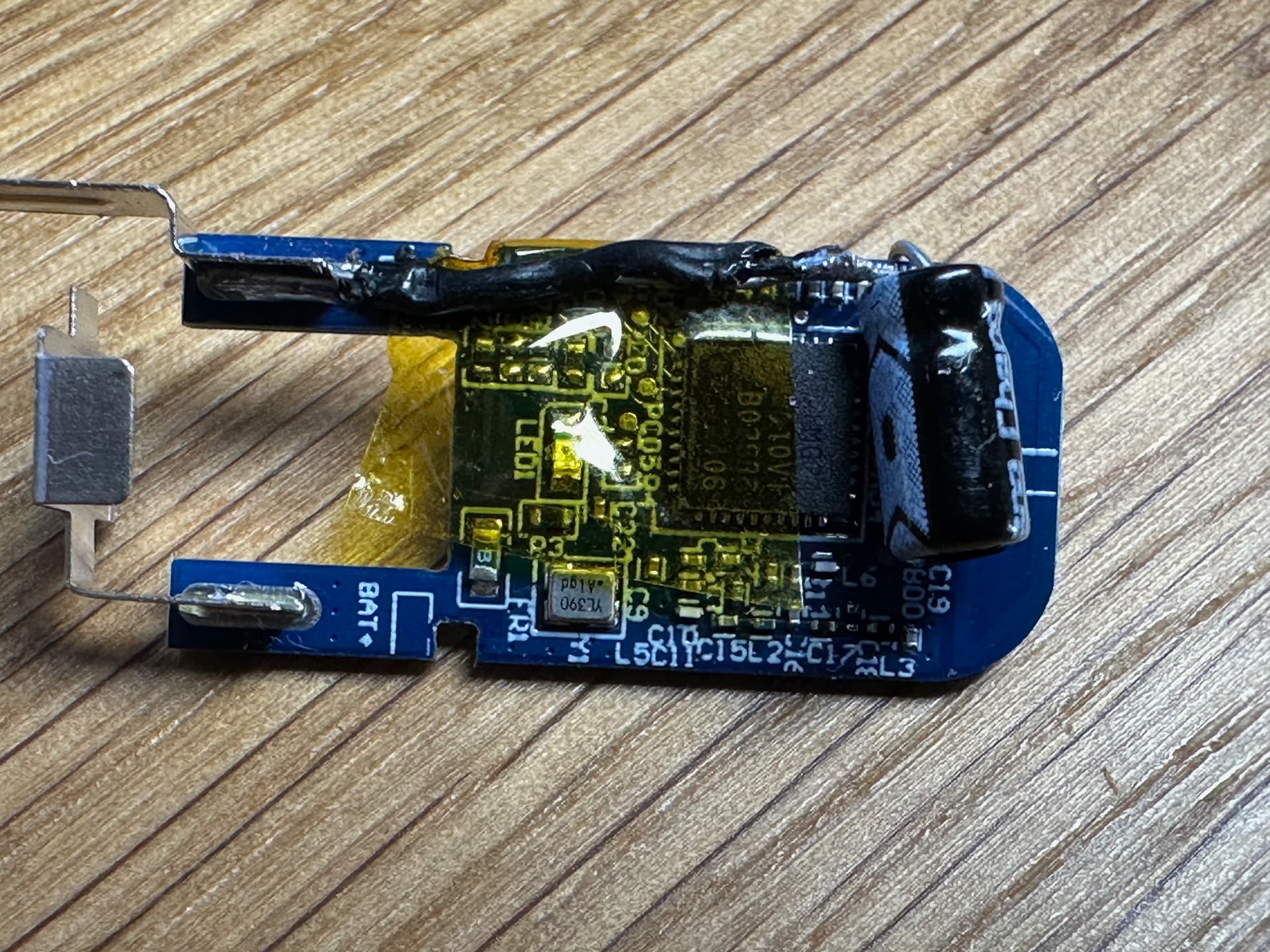

Could you tell me how to connect it correctly and what the minimum capacity should be? The image is a bit blurry/to zoomed out to see.
Also, what is the best way to open it up? Your casing seems mostly intact.
Thanks!

found one of your comments on your YT video’s: ā€œā€¦I just added a 10uF capacitor across VCC and GNDā€¦ā€
Now to open one up without damaging the casing to much. :slight_smile:
Edit2:
Managed to open it. It seems to be glued somehow, all along the edge. Did manage to open one up without that much damage.
Added a 10uF capacitor and closed it again. Still works, woohoo :smiley:
So it does fit. (with small force), could be resolved my removing just a tiny bit of the inner casing or choosing a different path for the GND wiring.
Might have a small SMD capacitor somewhere… not sure what to minimum capacity should be?
Now wait and see how the battery will perform.
If possible / available, share some photos!!! I think people would want to see how exactly it is done, with some visual assistance & closed-up photos

where did you fit the cap?
GND (battery leg connector) <> VCC
Used kapton tape to make sure it does not short anything.
Extended the cap leg with a black wire (which is low quality as it melted somewhat as you can see :stuck_out_tongue: )
I do have way smaller capacitors which could fit right on top. But I do not have the equipment to measure if the solution is working with like 1/10 of the that capacity. So figured, first try with the exact same setup.
I might try and contact GNIF (Video owner) to know what to do.

I have some 10uF ceramic capacitors, those might be less of a tight fit.

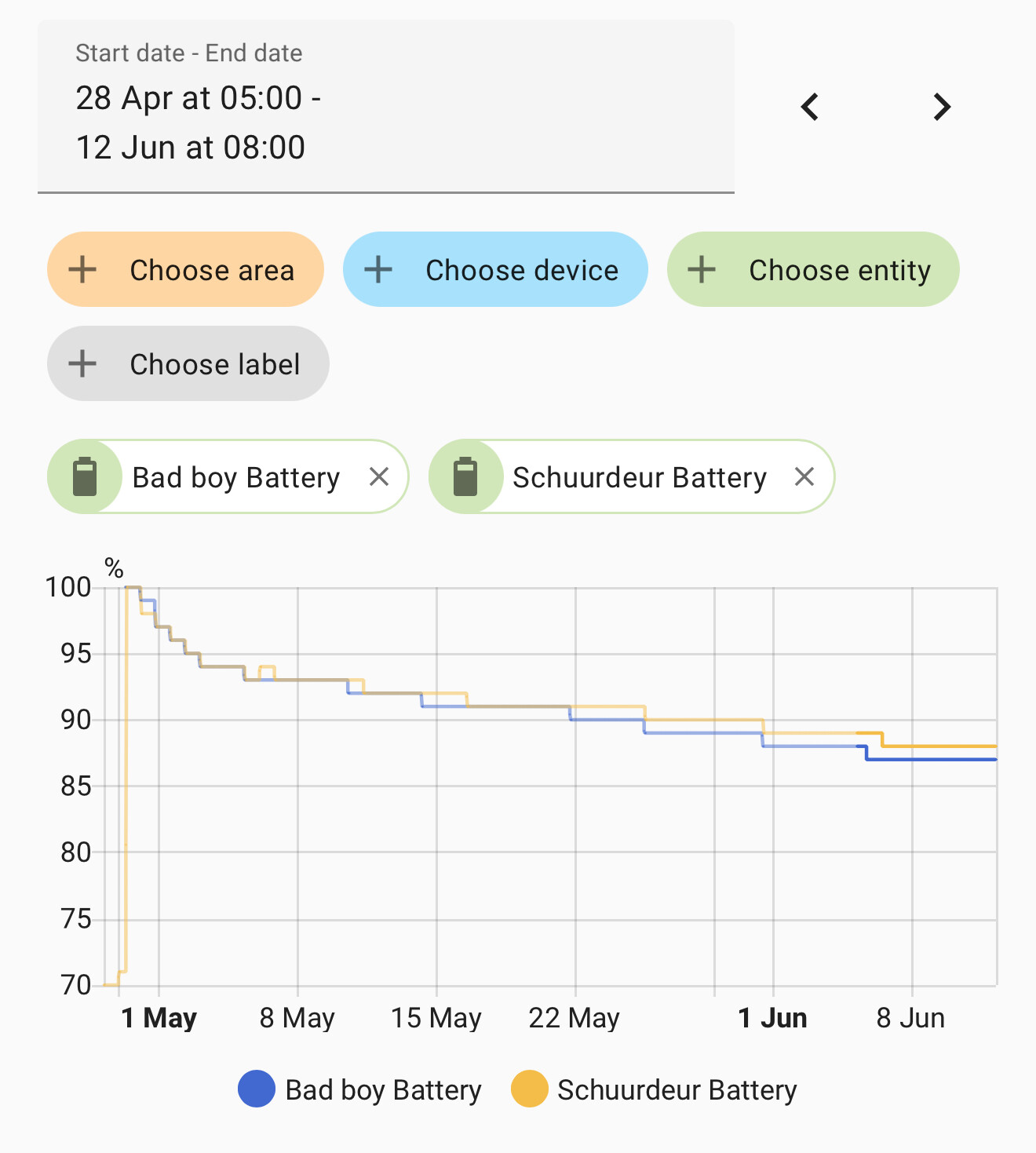

Have now been running the test for about 10 days, but cannot see any difference in battery capacity.
To be continued…

My test is now running for 45 days. Still no significant difference between the two sensors…
