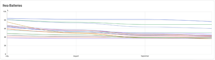

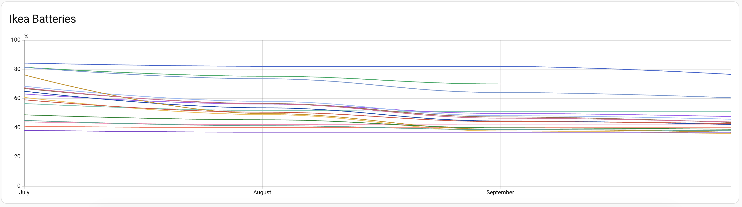

Here are some sensors which where replaced all about the same time. One is with the modification, can you tell? I couldn’t (and it’s not the green one).
Now lets check them all. (all with ladda 750 - charged with the IKEA charger)
Note, some batteries where replaced about 2 weeks ago. Just before I was away for more than a week.
Still completely unacceptable. The batteries should last for months, closer to a year… In total I bought like 15 of them, some not even mounted because of the issues (and possible mod).

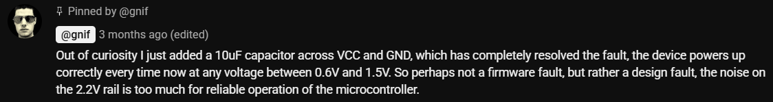

Bummer. The guy who uploaded the video on YouTube claimed that the capacitor would address the issue.

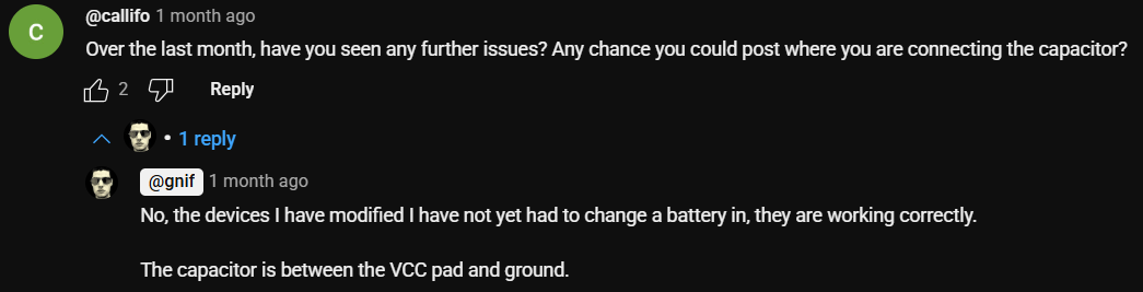

and then there was a follow up comment under his follow up video:

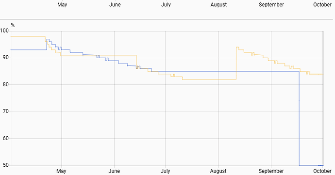

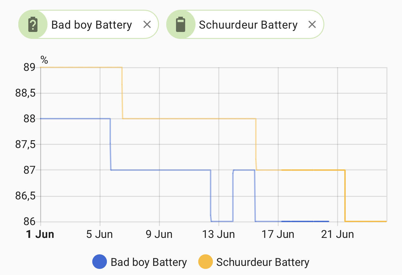

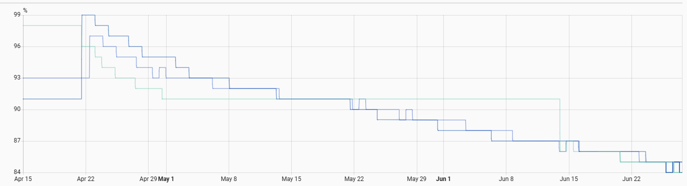

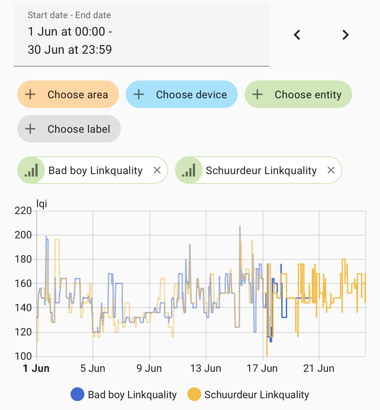

3 months later, time for an update.
My bad-boy parasoll is still working!
It’s not on a door, just lying around on shelf upstairs (further away from the main controller btw).
Once in a while I open and close to sensor to see if the red light works.

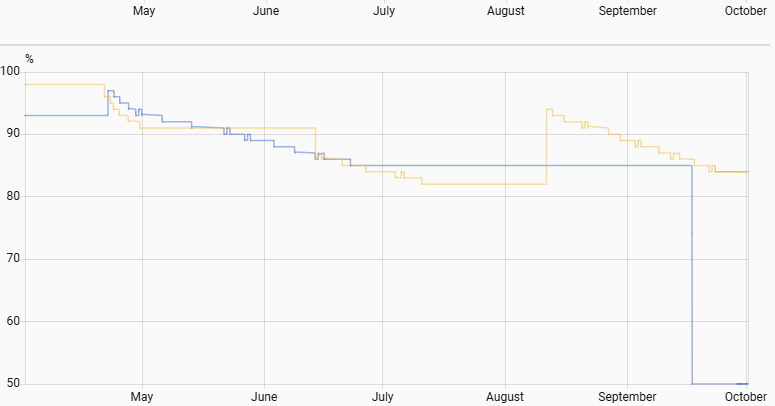

So, let’s get to the result!
Blue is the bad boy, replaced its battery around 21 of april (month after the mod).
Orange is of a door downstairs between living and hallway, so opens a lot (and is within 1m of the controller).
You can see that the battery has been replaced, it lasted for about 10 weeks without issues.
Was replacing 22 aug, and now giving issues since 23 sept. 1 month only.
Both times we were away for more than a week during this period.

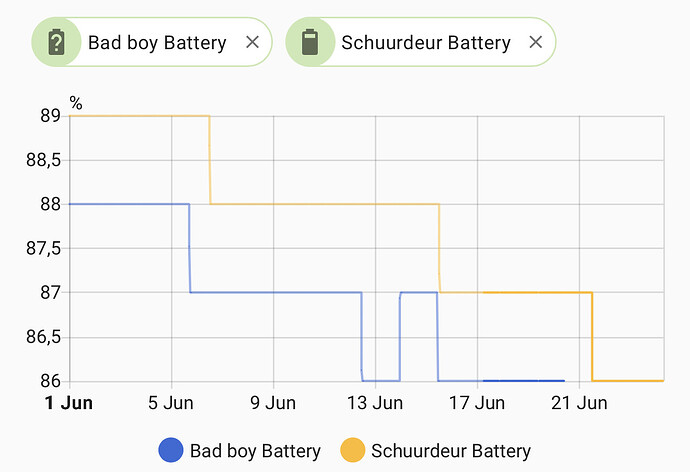

The modded version is lasting for 5,5 month now and still updating throughout the day/responding to open/close.
The original version longest period is 2,5 months the shortest 1 month.
So maybe the mod does work after all. The battery level is just not so accurate maybe, dropping form 85 > 50 overnight :wink:
Next I think I will place both sensors on the same door with fresh batteries.
Then when one runs out, I will mod the other one aswell and see how that goes.

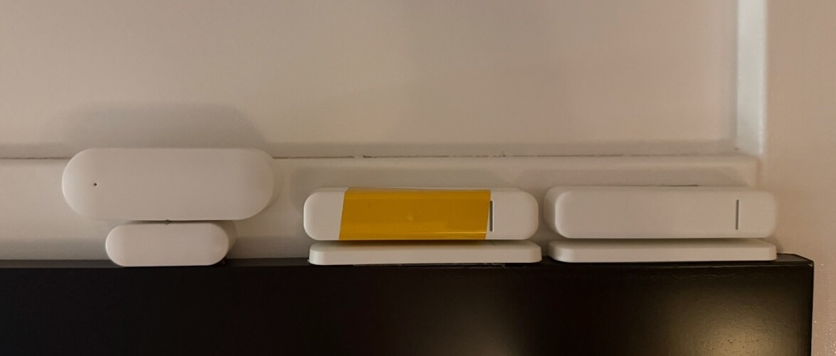

So, just to recap on the latest round of tests, essentially you have 3 door sensors on the same door, with one sonoff SNZB-04, and 2 of them being IKEA Parasoll.
Between the two Parasoll sensors, one of them being the blue “Bad Boy” sensor with the capacitor mod to reduce the noise, and the other one is the original Parasoll.
Do I understand your battery tests correctly?
I’m quite interested.
Correct. As in this picture.
Using Z2M (latest) using a SLZB-06 (latest stable firmwares), within 1 meter of that door. Besides these 3, there are 76 other Zigbee devices. Also quite some with batteries, like motion sensors (both IKEA and Philips). There is only this one wooden doorframe / panel between these 3 sensors and the antenna…
