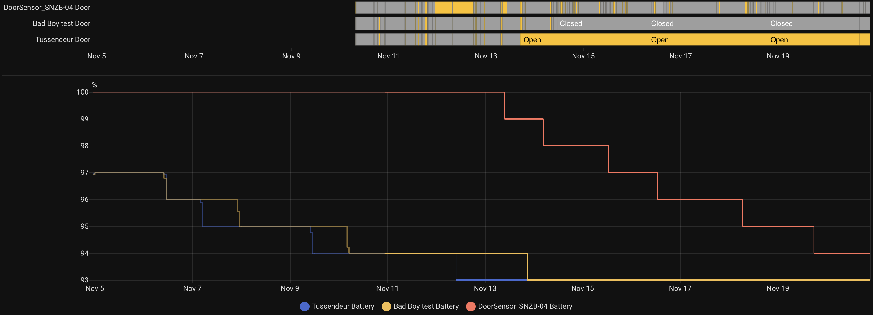

Both Original Parasoll with IKEA batteries and Bad Boy (modded parasoll) lasted 11-12 days.
The SNZB-04 is stil working (has two IKEA AAA’s).
I did notice it sometimes failed to report correctly, you can see this issue around nov 12 in the upper bar. I think this is because all 3 were next to each other. Since the IKEA sensors are dead, it seems to act normal.
Could it be that the sensors perform worse battery wise when there is more interference (lots of 2.4 Ghz devices - like a wifi AP very close to the sensors)? In addition to a very busy door/windows of course.

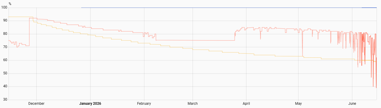

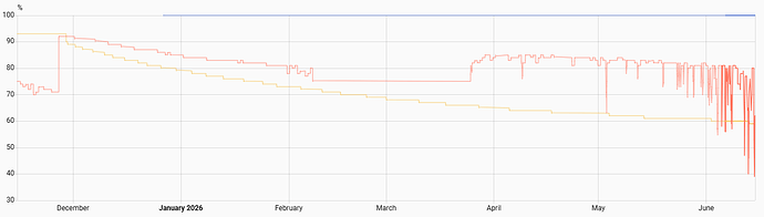

Months later. Guess this will be my last update in this now old topic.
Modded parasoll (red line) is on a door that opens like once a month (technical space). I needed to replace the battery 3 months in. It's really close (<1 meter) to the antenna.
Ewelink (aliexpress) (yellow line) is running almost 7 months on a really busy door (hallway to living) is now on 60%. Parasoll only did like 4 weeks there at tops.
New IKEA Matter Mygbett (blue) is still at 100%, but I must admit, this one is on an alkaline battery and I'm not sure if it will read the correct percentage because of that. My other Mygbetts are on recharables, they are 5 months in at 60%. It does not seem to matter if they are busy or closed 99% of the time.
Only Mygbetts (2) that run out where stuck in a firmware update/crashed. Light was on always and offline.
6+ months battery life on recharables is OK I think. 10-12 would be nice though.

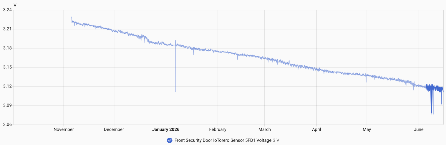

I might as well give an update on my athom bthome door sensor as I put this forward as a possible replacement item if you have a bluetooth device as an option over the Ikea one.
I had totally forgotten about batteries in this door sensor, I haven't replaced a battery since installing the device ~ 7months ago.
Still showing 100% battery left, not that I trust the %.
Thankfully it also exposes the voltage too. It has been slowly going down over time. This is the front door and is opened many times a day. The old IKEA sensor would last a few weeks at best on this door. This one is ~7 months in and still going, might get 10 out of it?
