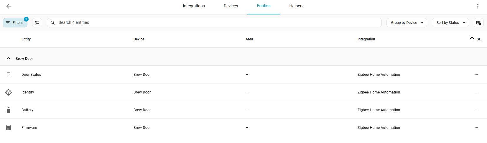

Go to /config/entities and select the device
For these you want the O Device Name entry (in my case Brew Door)
hit the - next to the integration name (in my case Zigbee Home Automation)
THEN hit the Cog on that window and set the SHOW AS to DOOR.
Boom. Fixed.
