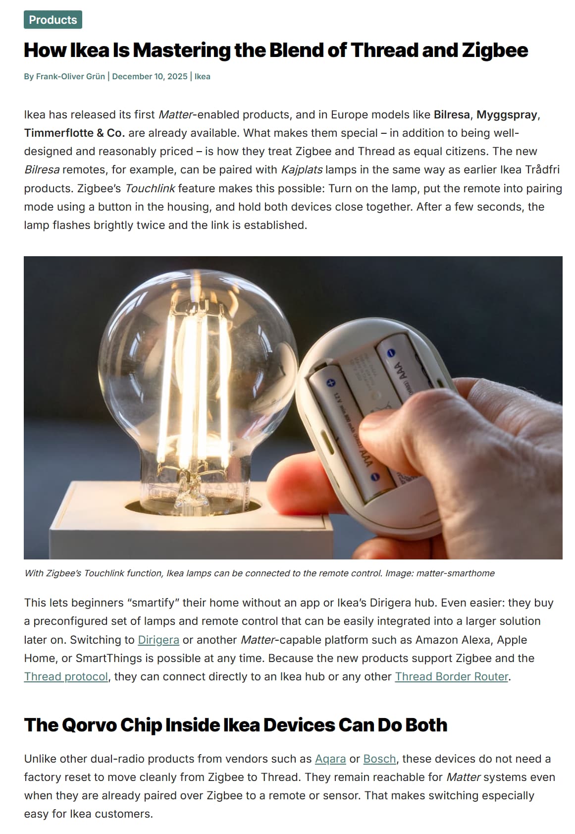

The new Ikea commanding devices (contact sensors, buttons, and controllers) communicate in either Zigbee or Matter over Thread. It uses some new chip that can switch between the two. In other words, the new devices will still work with the old bulbs. It’s kinda interesting to read about.
How Ikea Is Mastering the Blend of Thread and Zigbee | matter-smarthome
My understanding is that you can pair the new and old devices directly (without hub) via Zigbee touchlink.
But you cannot pair the new devices to a Zigbee hub. You can pair the new devices only via Matter over Thread to a Thread radio (but I may be wrong).
(so still, you have the largest choice if you have both: a Zigbee and a Thread stick/radio)
There’s several reports that the Matter devices from IKEA can be paired to “hubs” like Zigbee2MQTT.
