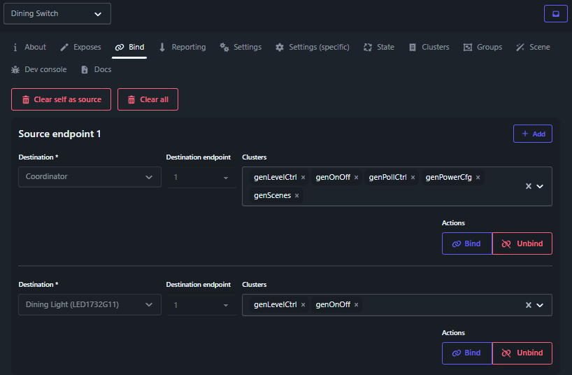

Remote/Switch:
Bindings:

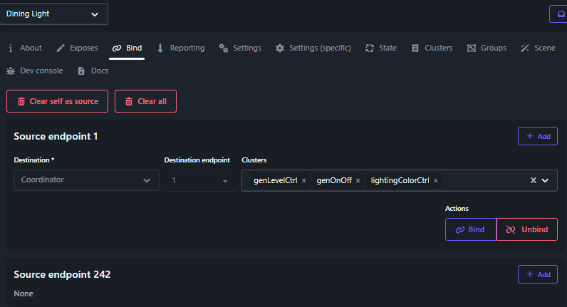

Dining light:

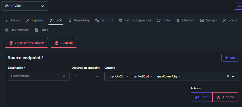

Water Valve
