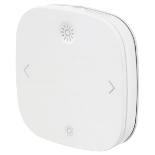

This blueprint turns an IKEA STYRBAR (E2313) into a two-light controller via Zigbee2MQTT, where the second light inherits the brightness and colour of the first instead of coming on at whatever it was last set to.
It grew out of a simple annoyance: switching on a desk lamp and a ceiling light from the same remote and having them land on completely different colours and brightness levels. Everything the blueprint does follows from fixing that.
Gesture Action
Left arrow, short press Toggles the left light
Right arrow, short press Toggles the right light
Up, short press Brightens every light that is currently on
Down, short press Dims every light that is currently on
Up, hold Sets a warm colour temperature on the lights that are on
Down, hold Sets a cool colour temperature on the lights that are on
