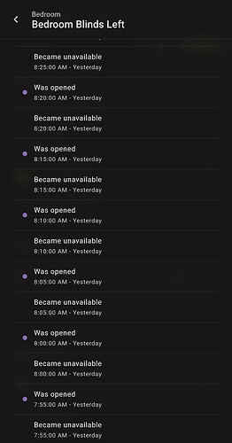

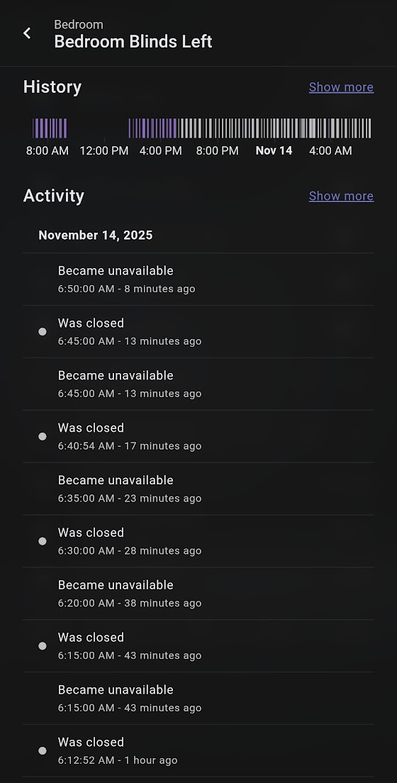

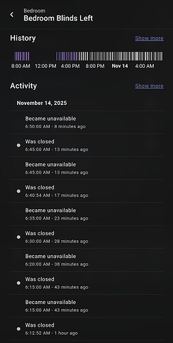

I’ve been running a stack of 34 Ikea devices with Home Assistant through the Tradfri hub for several years. Sometimes, devices will blip off the network EXACTLY every 5 minutes to the second for less than one second and then return.
This has been going on for several months.

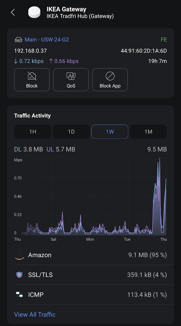

Another odd thing is the network traffic has suddenly spiked for no apparent reason.
I’m not sure why the hub would be hammering Amazon all of a sudden.

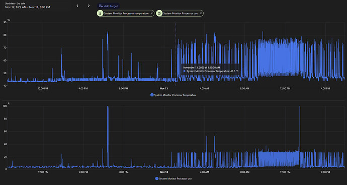

I also just noticed that HA started burning up the CPU starting at 1am for no known reason and hasn’t stopped since.
I certainly didn’t make any changes to HA at that time, though it could be the time Unifi updated. What UDM settings should I check for funky changes?

It might be trying to connect to check for updates, the total amount of traffic is 9.5MB, not that much either.

The CPU ‘only’ jumped 20% but your temperature is way higher…
Did you reboot the HA instance yet by any chance? If not try that as well, can’t hurt.
Yeah, I rebooted HA a few times today hoping it would clear up the IKEA connection issue. Going from from a consistent 3-5% CPU utilization to 25% CPU starting a 1am with no configuration changes is… concerning.

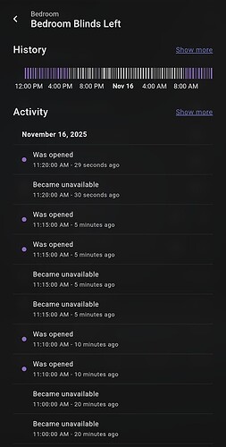

Somehow, the connectivity has gotten worse this morning from yesterday. Now HA will see the IKEA hub for 5 minutes, disappear for 5 minutes, then reappear for 5 minutes. The strangeness is the EXACTNESS of the blips down to the second, on the second, nearly every time.

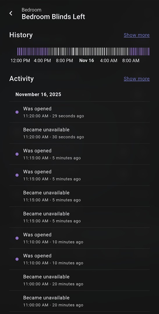

On top of all that, I have a new symptom: log entries are doubling up. The “Was opened” and “Became unavailable” are posting twice on the exact second.
