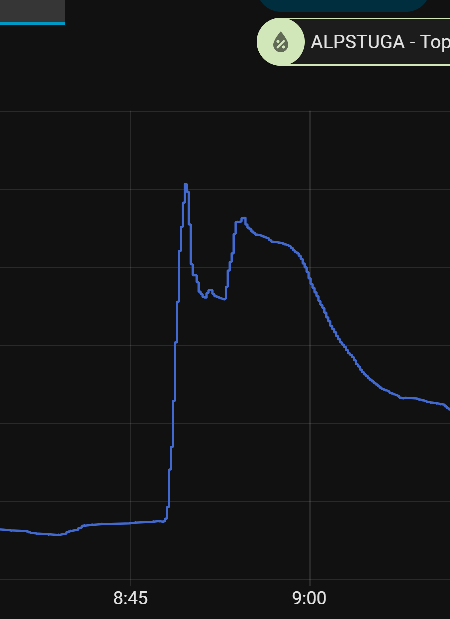

I’ve tried the Timmerflotte and it works fine when used with something like a derivative sensor to turn on a bathroom fan, but its slower than an Aqara temperature and humidity sensor, even though both do increase their reporting frequency when changes are rapid.
As does the alpstuga, which as you can see from this graph:-
Was reporting every few seconds (20-30) around 8.50 when the value was changing rapidly.
