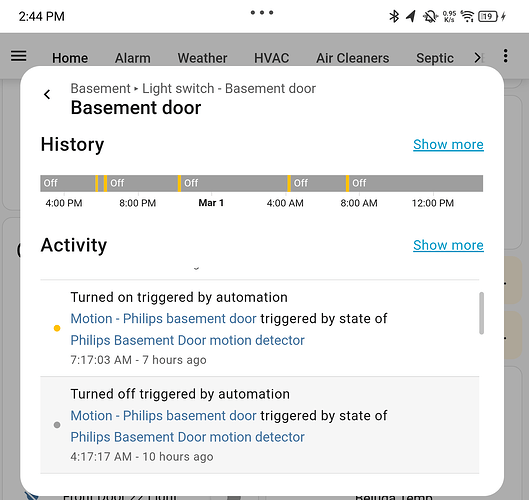

According to that, it didn’t turn on the light. Are you sure you don’t have another automation that did it? If you look at the log for the light, it should tell you why it turned on and what automation was responsible.
Thanks for the reply, and the hint.
However, it looks like the script did indeed turn it on.
turned on triggered by automation Motion - Philips basement door triggered by state of Philips Basement Door motion detector
5:42:40 PM - 44 minutes ago

But the light came on! And the only way to turn that light on is a button on my screen or an automation. (It’s not controlled by a physical switch.)
And it happened again, this morning, 7:19, sun well up, as I walked past it to take my dogs for a walk. So no tablet or phone, meaning I know I didn’t inadvertently tap my screen.
And exactly as last night, the trace from the automation says “I didn’t turn it on, it was too bright out” and the history from the light says “Yes, you turned it on”.
Automation trace says no.
Device history says yes.
I see only two options, HA logging has a defect or HA automations have a defect. I believe it’s the latter because the light came on.
Maybe I’m missing something obvious, but I can’t see it.

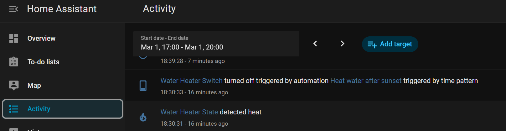

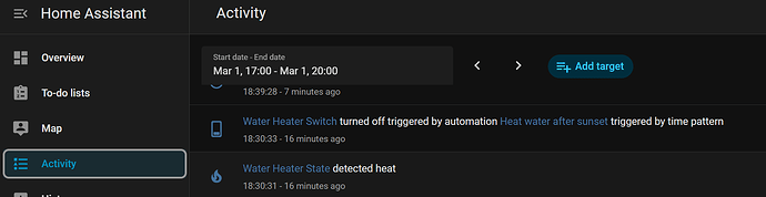

Home Assistant’s system clock operates with microsecond precision. The difference between the timestamps of the trace and light’s activity is 45 seconds which is enormous.
One of my automations controls interior lights based on illuminance. Yesterday, when it turn on lights, the trace’s timestamp was 17:45:03. I checked the activity log of several of the lights controlled by the automation and their timestamps ranged from 17:45:03 to 17:45:05. So within 2 seconds of the automation’s triggering.
In your latest screenshot, the light’s activity log indicates it was turned on at 7:17:03 AM. Please post the corresponding trace file. If it also indicates a 45 second difference, I suggest you submit an Issue to Home Assistant’s Github Core repository.
I’m guessing this may be the result of your home haunting. Check what automation you have added to incorporate this and if it is incorrectly triggering the other lights with inadvertent logic overlap.
