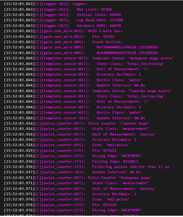

I can’t load the config, swears at errors
, the essence of the config is that the water meter is connected directly to the temperature sensors
The water meter counts correctly, the controller sees the temperature sensors in scan mode, but it does not assign sensor addresses.

Not your code, neither your logs present dallas_temp component.
If you want support here, read the post above and edit your OP using code tags.

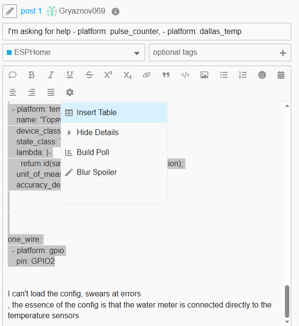

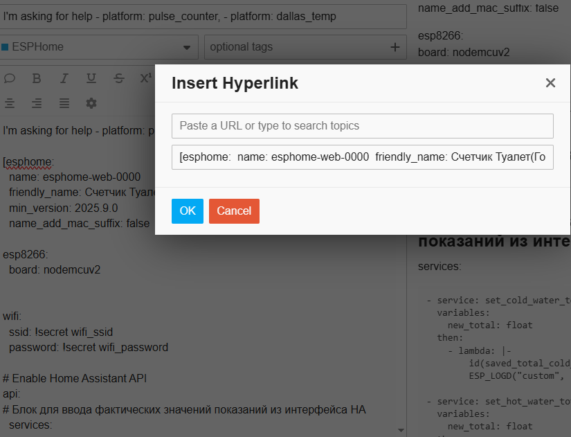

This is my first time creating a theme, I can’t figure out how to create it correctly.
Like this:
when I prescribe a tire scan, she sees the sensors
I don’t.
I only see one_wire, not dallas_temp.
f6be36681e0da431418ec7781fb6c62712941803
Uploading: 2025-11-26_16-32-02.png…
Uploading: 2025-11-26_16-32-30.png…

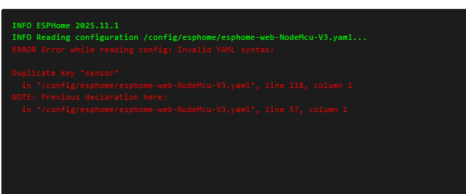

The “sensor” is duplicated, but it doesn’t work without it.
Remove this line:
Then correct the addresses on your dallas_temp sensors.
Default update interval is 60s, you might want to adjust that as well.
one_wire:
  - platform: gpio
    pin: GPIO2
sensor:
  - platform: dallas_temp
    address: 0xf30000001c698a28
    update_interval: 10s
    address: 0x6d000000203f9328
