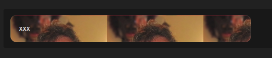

Just a quick test:
type: markdown
content: xxx
card_mod:
style: |
ha-card {
{% set PERSON = 'person.' + user -%}
{%- set IMAGE = state_attr(PERSON,'entity_picture') -%}
background-image: url({{IMAGE}});
Adapt this code to your case.
(assuming that a username is same as a person.entity_id)
This sets the background image for the card as entity picture. I am not much into YAML and ginger to handle this

Tested and it works well!
type: custom:mushroom-template-card
primary: Hello, {{user}}
secondary: How are you?
picture: |
{{state_attr(PERSON,'entity_picture')}}
Thanks much, this worked and met the requirements
