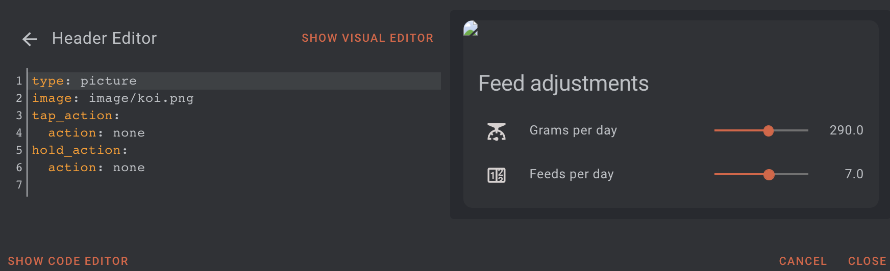

For some reason, as yet unfathomable to me, I can’t get images to show on cards in lovelace.
I have an image located here
The card is configured as below:
I know it’s just a path thing but I can’t figure it out.
I’ve also tried /config/image/koi.png.
Any suggestions that’ll point me in the right direction?

I have mine located in the www folder and use local/xxx.png as image path. That’s what works for me.

I don’t have a www folder.
Is your under config?
/config/www/

Thank you!
Turns out it also required a restart.
If anyone still runs into the same issue, I changed /local/floorplan.png to
http://homeassistant.local:8123/local/floorplan.png
and the floorplan finally showed.
I run HA in a virtual machine.
