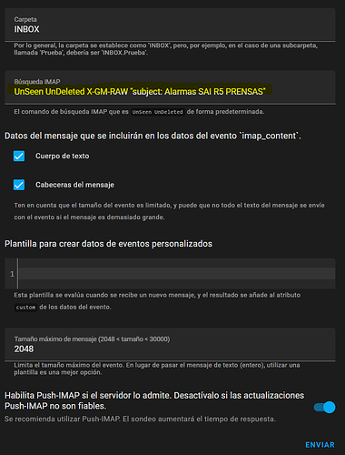

Start by setting up a second IMAP integration sensor that is specific to one of the alarms.
  1. From the Integrations dashboard select IMAP.
  2. At the bottom there should be a button that says “ADD ENTRY”. Click the button
  3. Fill in all your email info.
  4. From the screenshots you posted, it looks like this is a GMail account, which means you can use the X-GM-RAW search functions. For the “IMAP Search” field you should use:
UnSeen UnDeleted X-GM-RAW "subject: Alarmas SAI R5 PRENSAS"
  1. Save the configuration.
Now you can make your automation specific to the new sensor by using a more specific trigger, and you should be able to use the initial attribute to tell if it’s an active alarm:

ok, step by step…now i have two sensor
first one checks inbox unread and undeleted
second one did it as you said:
then if i set the new automation as you told me, its behaviour is the same, it does not take into account wheter there is a mail with Alarmas SAI R5 PRENSAS or not in inbox folder…
Focus on getting the IMAP sensor working as expected… The sensor’s value being “0” means there are no emails that match all parts of the search criteria. The search criteria currently has 3 parts, and all must be true:
  1. The email must not be marked as “Seen”.
  2. The email must not be marked as “Deleted”.
  3. The subject must match.
Did the automation run at all? If so, you should download and post the json file of the debug Trace.
Since UnSeen is the most volatile of the 3 criteria, I would remove it then re-run your tests.
