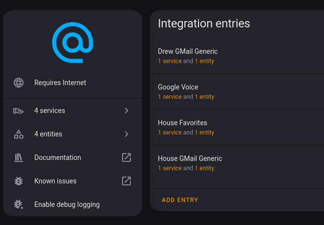

No, you can set up multiple services in the IMAP integration:
You don’t need to make one for every subject or sender, even making the search criteria a little more specific to it’s end use purpose can make it significantly more reliable.
