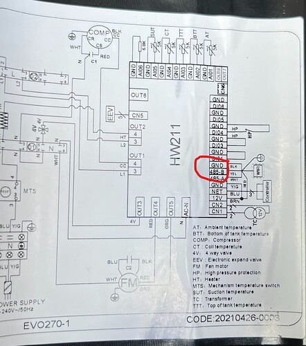

It is the modbus map of the hw211, i used an atom s3 lite esp32 with an rs485 to read the modbus variables to home assistant, works well
So you are using this RS-485 interface on the HW211? If so can you share more info about your setup, please? I am very interested in getting full control of this HWS.

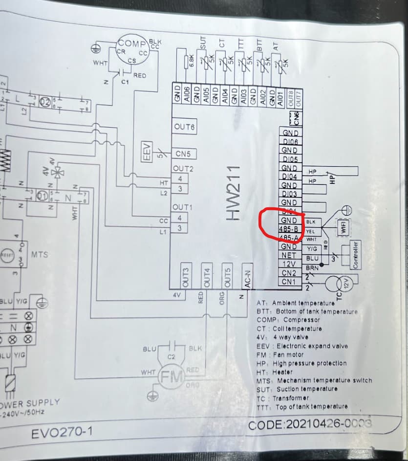

Yes, those 3 pins and the red for 12V as seen in picture below. Code below is reading the simple temperatures but using the modbus map full control can be achieved.
esphome:
friendly_name: ESP32 Atom S3 Lite HWS
min_version: 2024.11.0
name_add_mac_suffix: false
esp32:
board: esp32-s3-devkitc-1
framework:
type: esp-idf
Enable Home Assistant API
api:
encryption:
key: !secret hws_encryption
Allow Over-The-Air updates
ota:
  • platform: esphome
wifi:
ssid: !secret wifi_ssid
use_address: !secret hws_ip_address
Enable Web server.
web_server:
port: 80
RS485 UART Configuration
uart:
rx_pin: GPIO5
tx_pin: GPIO6
baud_rate: 9600
data_bits: 8
parity: NONE
stop_bits: 1
rx_buffer_size: 256
Add the Modbus controller
modbus:
uart_id: uart_bus
Sensors and controls for your hot water system
modbus_controller:
  • id: device_addr_1
    address: 99
    modbus_id: hws_modbus
    setup_priority: -10
sensor:
  • platform: wifi_signal
    name: “WiFi Signal db”
    update_interval: 60s
    entity_category: “diagnostic”
  • platform: modbus_controller
    modbus_controller_id: device_addr_1
    name: “Ambient Temperature”
    register_type: holding
    address: 2019
    value_type: U_WORD
    unit_of_measurement: “°C”
    accuracy_decimals: 1
    filters:
    • lambda: return (x-60)*0.5;
    name: “Bottom Tank Temperature”
    address: 2020
    value_type: U_WORD
    filters:
    name: “Top Tank Temperature”
    address: 2021
    value_type: U_WORD
    filters:
    name: “Coil Temperature”
    address: 2022
    value_type: U_WORD
    filters:
    name: “Suction Temperature”
    address: 2023
    value_type: U_WORD
    filters:
