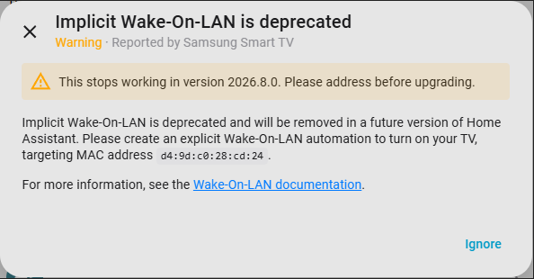

Implicit Wake-On-LAN is deprecated (Samsung Smart TV integration)
Hi Guys!
Today i got the following message:
I know how to resolve this, so i can turn on the tv over Wake-On-LAN.
Does anybody know how to TURN OFF the TV in the future?
How do i obtain the current status if the TV is ON or OFF?
TIA

The media player entity will show its on/off state and you can turn it on and off with the media player entity. The on action from the media player will cause the WOL automation to run:
alias: Turn On Living Room TV with WakeOnLan
triggers:
  - trigger: samsungtv.turn_on
    entity_id: media_player.living_room_tv
actions:
  - action: wake_on_lan.send_magic_packet
      mac: xx:xx:xx:xx:xx:xx
Thank you, I obviously made a mistake in my thinking.
I thought it was related to turning it off, but it’s only the WoL function that’s changed in the integration. All other commands don’t use WoL.

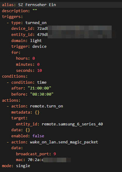

This is my automation now for turning it on:
alias: Bedroom TV on by nightlight
description: ""
triggers:
  - type: turned_on
    device_id: xxxxxxxxxxxxxxxxxxxxxxxxxxxxxxxxxxxx
    entity_id: xxxxxxxxxxxxxxxxxxxxxxxxxxxxxxxxxx
    domain: light
    trigger: device
    for:
      hours: 0
      minutes: 0
      seconds: 10
conditions:
  - condition: time
    after: "21:00:00"
    before: "08:30:00"
actions:
mode: single
That will work for that automation, but if you try and turn on the TV with the media player entity it won’t work
