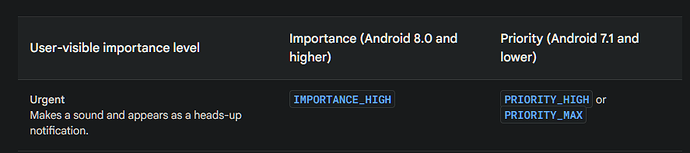

Shows priority but then the fcm doc link
shows importance for 8.0 and newer.
priority is ignored on later versions of android and is only used for FCM for the message delivery.
importance is only set the first time you create teh channel and is ignored everytime after
most of us just use priority for the critical format, once you set teh importance for your channel you never need to set it again.

On a side note, I have been using priority for years without a problem and I don’t have one now. I was re-reading through the docs and noticed that in critical the example given uses priority, however the channel example uses importance. I assume both would reflect the current format.
Are they interchangeable?
no they are different. Heres a better breakdown.
  1. You send a message from the server either via automation or service call etc…
  2. That message first goes to firebase where the priority value is first handled for critical notifications. This step and the next step are skipped if you are using persistent connection
  3. Firebase sends the message to the app after processing ttl and priority
  4. Device receives the notification and processes things and thats where the docs are correct that lower versions of android ignore it.
The critical format is important for speedy delivery of the notifications so that you always get them even if the device is sleeping (dozing). That happens before teh app processes the rest of the notification like text and image etc…
It is confusing because both firebase and google use priority for different things but the name still needs to remain teh same.
