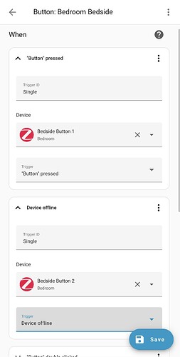

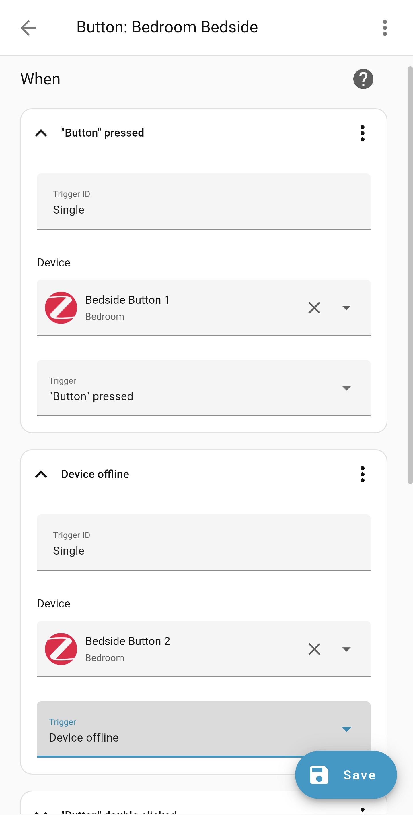

Ive also just got the buttons (zb-k1), managed to add them to HA but they don’t appear in automation actions like others do:
Anyone any tips? Tempted to just stick with the Sonoff SNZP-01P (Button 1 in the images)
Try pressing the button once (and maybe restart HA after that). Most times, that’s enough to get the event to show up in the automation.

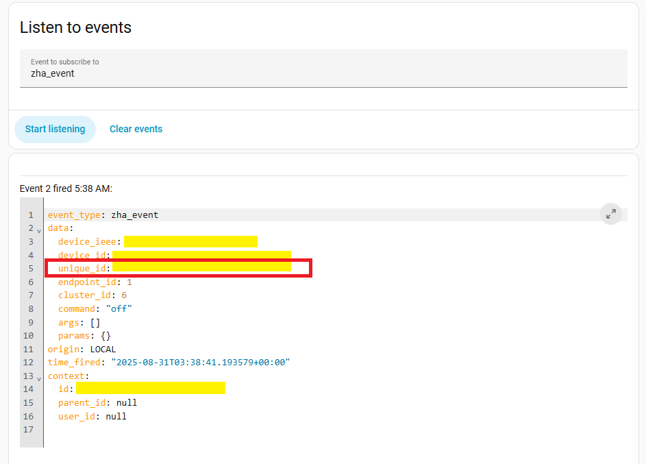

If that doesn’t work, you will need to use an event trigger. Go to Dev tools > Events, and enter zha_event > Start listening. Pressing the button should fire an event which you can use in your automations.
I also came across this cheap button on AliExpress. I ordered one. It appears as CK-TLSR8656-SS5-01(7000) by eWeLink on my device, but the box says zb-k1.

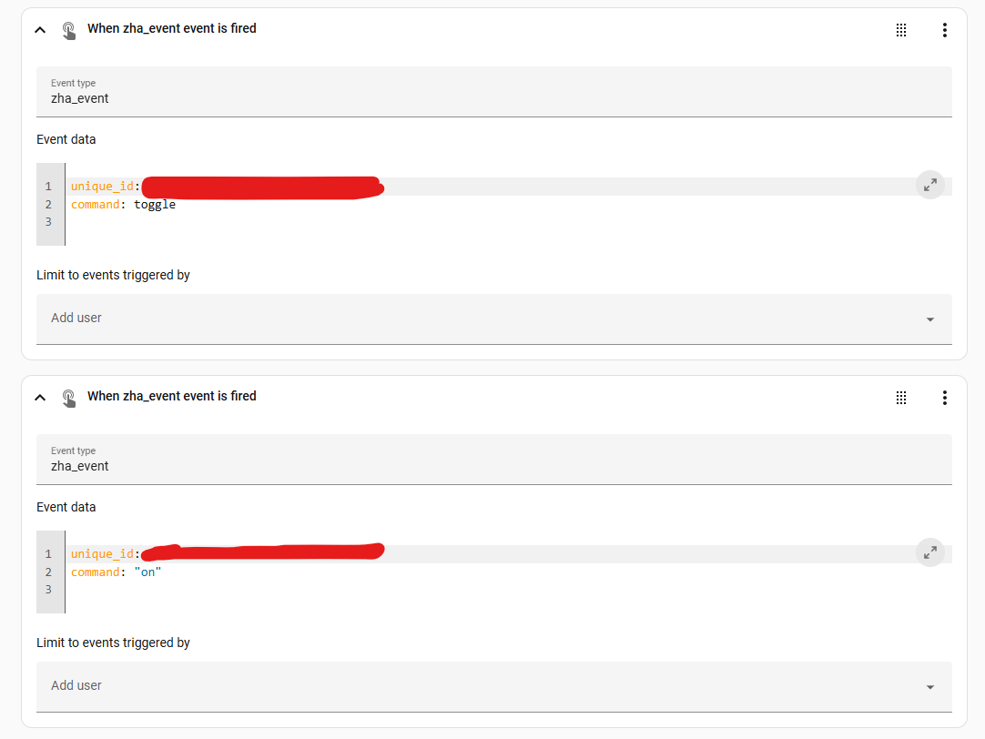

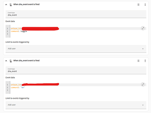

Based on ShadowFist’s post, I managed to figure out that it can generate three types of events (single click → toggle, double click → “on”, long press → “off”). Based on this, I was able to create an automation trigger for it.
You can find your device’s uniqe_id here.
Hi @gyandor, I have the same problem with these button.
I found the unique_id in the listen section, but I dont’ understand what is the section in the first image, or how to go foward for obtain an action when I push the button…

First image is an automation trigger setup.
I had caught the event before when I was listening to zha_events as
ShadowFist wrote.
