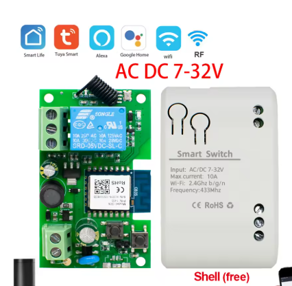

This is the particular relay

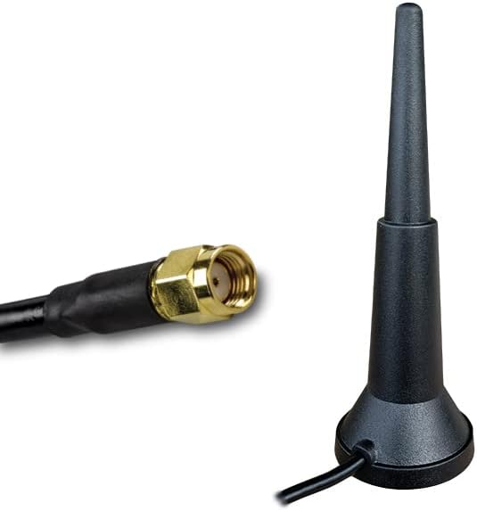

I think the antenna is a coiled wire at the top of the circuit board (or is it the circuit board trace on the chip board?). Could I connect a coax pigtail to the antenna connection point and mount an antenna on the outside. Perhaps something like this
Would it improve the signal enough to be more stable?
The coil is likely the antenna for 433MHz. The antenna for Wi-Fi is the circuit board trace on the chip board.
That coiled wire is 433Mhz antenna, not wifi.
The resonant frequency for your Tuya based WiFi antenna should be 2.4Ghz and connected to the Tuya module on the side, not the little black coil next to the blue relay at the top of the board that is for 433Mhz . Try an external antenna and see. Waterproofing will be your main concern. Loop the wire so any potential drips are away from any circuitry.

Your photo isn’t the clearest. What Tuya board is being used? CB3S? See CB3S Module Datasheet-Tuya Developer Platform-Tuya Developer and https://www.elektroda.com/rtvforum/topic4016376.html

Many thanks @neel-m and @Karosm . What is the 433mhz used for? I thought both Bluetooth and Wi-Fi shared the 2.4Ghz antenna or is that only on ESP2 boards?

Sorry @IOT7712 it was a snip from the AliExpress website. From what I can make out, yes its the CBS3 Tuya module.
I don’t want to cut holes in the gate control box as its still under warranty. however there are cable glands at the bottom I can feed the coax through. I would need an antenna with a coax approximately 800mm long. Is this likely to impact signal strength through losses rather than a shorter coax pigtail?
As far as I am aware I am not using the 433Mhz only Wi-Fi. As I said to neel-m and Karosm I am not sure what this antenna is for.
Yes, 2.4G pcb antenna on Esp is used for wifi/bluetooth. But that relay has additional 433MHz control option. You can pair it with 433 transmitter.

Be aware of the resonant wavelength of 2.4Ghz (the standard frequency the Tuya CB3S module uses), and penetration hole sizes approaching these dimensions of around 5 inches/11cm may actually form a waveguide that can attenuate signals. Sticking an antenna at the end of shielded coax cable of indeterminate length (800mm is fine) is standard practise, as long as the antenna itself is of correct resonant wavelength as a multiple/divisor of it, and your coax is properly grounded. At 433Mhz (apparently unused in your scenario but a possible security weakpoint where a passer-by with a 433Mhz controller could operate your gate - snip the black curly pigtail antenna off flush at the circuit board if you are not using the 433Mhz portion and measure it in case you need it in the future), it is a lot simpler, and the pigtail antenna may vary by quite a bit and still be good enough.
At 2.4Ghz WiFi frequencies, it is more critical, but as long as some signal improvement is achieved, you may be able to get away with it. Putting your device outside the metal box, on the side facing your WiFi device/router (the signals on those wires not being at radio frequencies) will be probably work better - using cables that are mains rated in thickness will result in negligible loss as you only have power connections wired to the board. Try it with temporary wire extensions (suitably insulated for safety reasons) but hanging free without putting it inside a plastic waterproof enclosure, and see how well it works. Same with an external 2 4Ghz antenna - just make sure there is proper grounding as this forms a critical part of the antenna functionality and effectiveness. This also give you room for orientation experiments to find the optimum way to point the antenna to get the best signal.
If pointing a stick antenna up on the outside of the metal enclosure works best, try pointing down at the bottom, and you may find it is just as good but less exposed to the weather for longer life, and you can use the grommets to pass the coax through.
A 2.4Ghz stick antenna rated for 3dB gain gives you double the signal. 6bB four times - it is exponential. No point in going for anything too expensive as the benefits of a bigger antenna don’t necessarily improve with greater expense, as now you are picking up signal from other devices and interference from other devices too. Monitor your signal strength. The existing -84dBm is at the lower threshold of good transmission. If you can raise it to the -70’s then you should notice significant improvement in reliability.

Unfortunately that’s not really practical due to the way the gate installers terminated the cables to the lights. I could drill a hole in the side of the cabinet to take the sma connector if I can find a panel mount one that’s “water resistant”. This would keep the coax length much shorter.

Try it first with the antenna free, just hanging out the door with the coax connected and see how directional it is and how much extra signal boost you get in real life.
Use a generous amount of outdoor rated, non-corrosive curing silicone sealant between the base and the antenna over the hole before you do up the screw for a reliable waterproofing solution.
