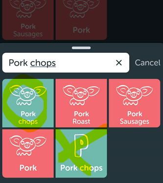

i.e. I have 2 x Pork items but one is Roast the other is Sausages and also a Chicken ( Crumbed Schnitzel) but in HA it only shows up as Pork and Chicken.
This is the App
This is the Web App
This is HA

When you start typing Pork Chops for instance it knows if it is a sub topic or not or a new product with a big “P”, if it is there than it has the Porky picture :slight_smile:
also if you click on a product and hold for a second or two a submenu comes up, you can add pictures additional Items and quantities, etc

Is it possible to keep the items separate? i.e Pork: Sausages and the other line would be Pork: Roast.
If you are using it for shopping you don’t want multiple items in the same tick box, kinda defeats the purpose, I’m surprised it is viewed this way in the web version TBH

I didnt realise you can select more than 1 “sub category”
Im not sure how im going to deal with that, as this is what Bring! returns via API
{'specification': 'Chops, Fillet', 'name': 'Pork'}
The problem is if i then just say – hey put Pork - Chops into my recent list, it moves Pork - Chops into the recent list and DELETES Pork - Fillet … ie Pork now just exists with a single sub title thingie.
Yeah, I noticed you can have multiple ‘specifications’ under one ‘name’ and it combines them in the web version but not in the Android app.
