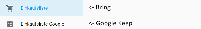

However, I must admit I’m still a bit confused. Here are my to-do lists:
  • ā€œtodo.google_keep_einkaufslistā€ (It contains all the groceries I’ve added using the voice assistant, which works fine so far.)
  • ā€œtodo.einkaufslisteā€ (It lists all the groceries I’ve added in the Bring! app.)
  • ā€œtodo.einkaufsliste_2ā€ (I created this list as a test because it was recommended in this forum thread.)
I have set up the blueprint twice in the automations, once for ā€œtodo.google_keep_einkaufslisteā€ and once for ā€œtodo.einkaufslisteā€ associated with Bring.
Oddly, Google Keep is syncing with ā€œtodo.einkaufsliste_2ā€ (<- HA Shopping List), although it is not listed in any of the blueprints :sweat_smile:.
