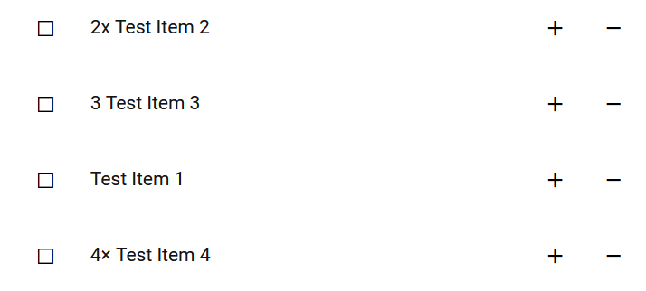

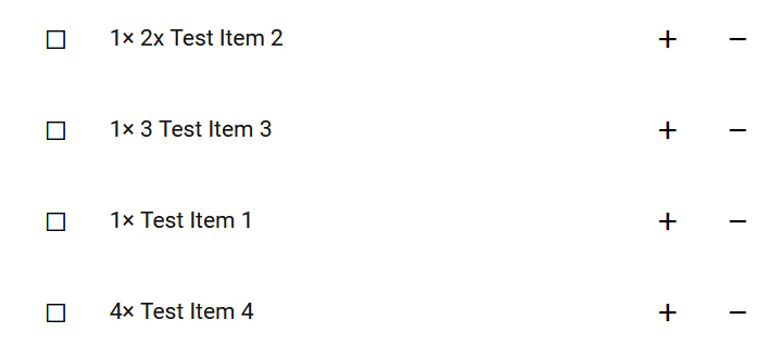

PSA:
Something I wanted to show the users if there is anyone updating the todo list from other places (automatons, etc) that have quantities like I do from both my inventory system and Mealie. For example:
If you have the Show quantity 1 turned on
Those items will display like
Test Item 1 is fine because of no quantity. So, add 1× to it is not an issue.
Test Item 4 is fine because it uses the proper special character that Mindreader programmed.
Test Items 2 and 3 don’t look good because it can’t tell you have added the quantity.
Of course, if you do not have the Show quantity 1 option turned on, they all look fine.
My point of this post is to say that if you are adding to the todo list yourself with quantities and want them to always work, you have to store the item as:
quantity followed by the special character × and a space, then the item.
That is not the letter X (lower or upper case).
You can copy the character below:
Also, that allows the item to be put in the proper category in the card.

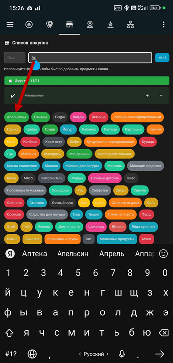

I see a filter has appeared, but that’s not quite what I meant. I meant a filter by chips (something like T9 mode for auto-completing words).
My family has exactly this problem: it’s very inconvenient to type on my phone, and they constantly pull me back to the “BuyMeAPie” app.
Try this link (it’s really implemented very conveniently there):
In any case, I really like your card and am following its development. All the best.
You mean like this image:
Yes, it is very convenient for filling
Now it's like this

I released v2.3.0-BETA-2 to implement your request, now you can filter the list and/or the chips
  • Added an option to filter the chips as well while typing in the input field (Chips)
