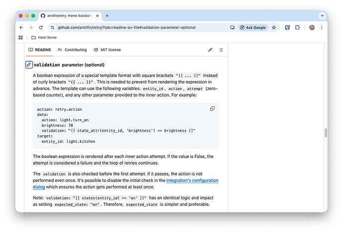

Dear readers,
How do have the retry thing make sure the lights aren’t only turning on, but also in fact the wanted colour and brightness too.
And is this also possible with scenes?
Thanks!
Joshua
