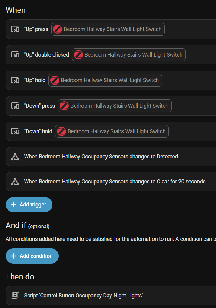

alias: Control Bedroom Hallway Lights
description: ""
triggers:
  - device_id: 359bc5a5f510d587696d3042b560c8b7
    domain: zha
    type: press
    subtype: Up
    trigger: device
    id: "Button: Turn on Lights"
    domain: zha
    type: remote_button_double_press
    subtype: Up
    trigger: device
    id: "Button: Turn on Occupancy Sensing"
    domain: zha
    type: hold
    subtype: Up
    trigger: device
    id: "Button: Turn on Daytime Lighting"
    domain: zha
    type: press
    subtype: Down
    trigger: device
    id: "Button: Turn off Lights"
    domain: zha
    type: hold
    subtype: Down
    trigger: device
    id: "Button: Turn off Occupancy Sensing"
  - entity_id:
      - binary_sensor.bedroom_hallway_occupancy_sensors
    to: "on"
    id: "Occupancy: Turn on Lights"
    trigger: state
  - entity_id:
    to: "off"
    id: "Occupancy: Turn off Lights"
    trigger: state
    for:
      hours: 0
      minutes: 0
      seconds: 20
conditions: []
actions:
  - metadata: {}
      nighttime_brightness: 7
      lights:
        - light.bedroom_hallway_lights
      trigger_id: "{{ trigger.id }}"
      daytime_lighting_mode: Adaptive
      nighttime_lighting_mode: Nighttime
      occupancy_sensing: input_boolean.bedroom_hallway_occupancy_sensing
    action: script.control_button_occupancy_day_night_lights
mode: restart

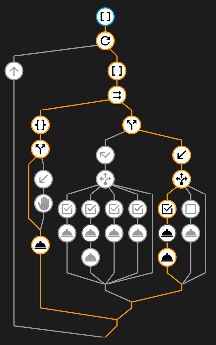

alias: Control Button-Occupancy Day-Night Lights
fields:
  lights:
    description: A list of lights to control.
    example: light.living_room_lights, light.kitchen_lights
    required: true
    selector:
      entity:
        multiple: true
        domain: light
  occupancy_sensing:
    name: Motion Sensor Toggle
    description: Toggle that controls whether motion sensing is on or off.
    example: input_boolean.living_room_occupancy_sensing
    required: false
    selector:
      entity:
        multiple: false
        domain: input_boolean
    selector:
      select:
        options:
          - Adaptive
          - Bright
    name: Daytime Lighting Mode
    default: Adaptive
    required: true
    description: >-
      Lighting style that turns on during the daytime. Adaptive is normal and
      changes based on the weather. Bright is great for closets or rooms where
      you want always-bright lights.
    selector:
      select:
        options:
          - Nighttime
          - Adaptive
          - Bright
          - Scene
          - None
    name: Nighttime Lighting Mode
    default: Nighttime
    required: true
    description: >-
      Lighting style that turns on during the evening. Nighttime is a calmer
      light temperature whereas Adaptive and Bright are the same as daytime
      lights.
    selector:
      number:
        min: 1
        max: 100
        step: 1
    name: Nighttime Brightness (Optional)
    description: >-
      Only used when selecting "Nighttime". The brightness setting used during
      nighttime lighting.
    required: false
    default: 20
  nighttime_scene:
    selector:
      entity:
        domain: scene
    name: Nighttime Scene (Optional)
    description: >-
      Only used for the "Scene" mode. Meant for specific rooms and lighting
      needs where only specific lights need to be turned on with specific
      brightness and color values.
  trigger_id:
    selector:
      template: {}
    required: true
    description: "Trigger ID used to determine which path use when controlling lights. "
    default: "{{ trigger.id }}"
  id:
    selector:
      text: null
    description: >-
      This is an always-running script until lights turn off, so you need to
      pass a unique ID, so its operation isn't duplicated.
    required: true
sequence:
  - data:
      message: >
        {% set light_names = lights | map('state_attr', 'friendly_name') |
        join(', ') %} "{{ trigger_id }}" ➡️ "{{ light_names }}".
    enabled: true
    alias: Log Trigger ID and Light Names
    action: logbook.log
  - choose:
      - conditions:
          - condition: or
            conditions:
              - condition: template
                value_template: "{{ trigger_id == \"Button: Turn on Lights\" }}"
                alias: "Trigger ID is \"Button: Turn on Lights\""
              - alias: "Trigger ID is \"Button: Toggle Lights\" and lights are off"
                condition: and
                conditions:
                    value_template: "{{ trigger_id == \"Button: Toggle Lights\" }}"
                    alias: "Trigger ID is \"Button: Toggle Lights\""
                  - alias: Are lights are off?
                    condition: template
                    value_template: >-
                      {{ lights | map('states') | select('eq', 'on') | list |
                      length == 0 }}
              - condition: and
                conditions:
                    value_template: "{{ trigger_id == \"Occupancy: Turn on Lights\" }}"
                    alias: "Trigger ID is \"Occupancy: Turn on Lights\""
                    value_template: >-
                      {{ is_state(occupancy_sensing, 'on') if occupancy_sensing
                      is defined else True }}
                    alias: Motion sensor toggle is "on"
                alias: >-
                  Trigger ID is "Occupancy: Turn on Lights" and motion sensor
                  toggle is on
            alias: If Button or Occupancy turn on lights
        sequence:
          - alias: Turn on lights and turn off occupancy sensing
            parallel:
              - alias: Turn off occupancy sensing if button pressed
                if:
                    value_template: >-
                      {{ trigger_id == "Button: Turn on Lights" or trigger_id ==
                      "Button: Toggle Lights" }}
                    alias: >-
                      Trigger ID is "Button: Turn on Lights" or "Button: Toggle
                      Lights"
                then:
                  - alias: Turn off Occupancy Sensing
                    metadata: {}
                      occupancy_sensing: "{{ occupancy_sensing }}"
                      action_name: Turn off Occupancy Sensing
                    action: script.control_motion_lights
              - metadata: {}
                  daytime_lighting_mode: "{{ daytime_lighting_mode }}"
                  nighttime_lighting_mode: "{{ nighttime_lighting_mode }}"
                  nighttime_brightness: "{{ nighttime_brightness | default(0) }}"
                  nighttime_scene: "{{ nighttime_scene | default('') }}"
                  lights: "{{ lights }}"
                  id: "{{ id }}"
                action: script.turn_on_day_night_adaptive_light
                enabled: false
              - action: script.turn_on
                metadata: {}
                  variables:
                    id: "{{ id }}"
                  entity_id:
                    - script.turn_on_day_night_adaptive_light
                enabled: true
        alias: Turn on Lights
      - conditions:
            value_template: "{{ trigger_id == \"Button: Turn on Daytime Lighting\" }}"
            alias: "Trigger ID is \"Button: Turn on Daytime Lighting\""
        sequence:
            parallel:
                metadata: {}
              - metadata: {}
                  id: "{{ id }}"
                action: script.turn_on_lights_for_adaptive_lighting
                enabled: false
                metadata: {}
                  variables:
                    id: "{{ id }}"
                  entity_id:
                    - script.turn_on_lights_for_adaptive_lighting
                enabled: true
        alias: Turn on Daytime Lights
      - conditions:
          - condition: or
            conditions:
                value_template: "{{ trigger_id == \"Button: Turn off Lights\" }}"
                alias: "Trigger ID is \"Button: Turn off Lights\""
              - condition: and
                conditions:
                    value_template: >-
                      length > 0 }}
                    alias: At least one light is "on"
                alias: "Trigger ID is \"Button: Toggle Lights\" and a light is on"
              - condition: and
                conditions:
                    value_template: "{{ trigger_id == \"Occupancy: Turn off Lights\" }}"
                    alias: "Trigger ID is \"Occupancy: Turn off Lights\""
                    value_template: >-
                alias: >-
                  Trigger ID is "Occupancy: Turn off Lights" and motion sensor
                  toggle is on
            alias: If Button or Occupancy turn off lights
        sequence:
          - alias: Turn off lights and turn on occupancy sensing
            parallel:
              - metadata: {}
                  transition: 1.5
                action: script.turn_off_lights
              - alias: Turn on Occupancy Sensing
                metadata: {}
                  action_name: Turn on Occupancy Sensing
        alias: Turn off Lights
      - conditions:
          - condition: or
            conditions:
                value_template: "{{ trigger_id == \"Button: Turn on Occupancy Sensing\" }}"
                alias: "Trigger ID is \"Button: Turn on Occupancy Sensing\""
              - alias: "Trigger ID is \"Occupancy: Turn on Occupancy Sensing\""
                condition: template
                value_template: "{{ trigger_id == \"Occupancy: Turn on Occupancy Sensing\" }}"
        sequence:
          - alias: Turn on occupancy sensing
            metadata: {}

“Turn On” Lighting Script
I have two long-running lighting scripts. This one controls the Adaptive lighting one.
This one controls whether we’re in daytime or nighttime lighting mode.

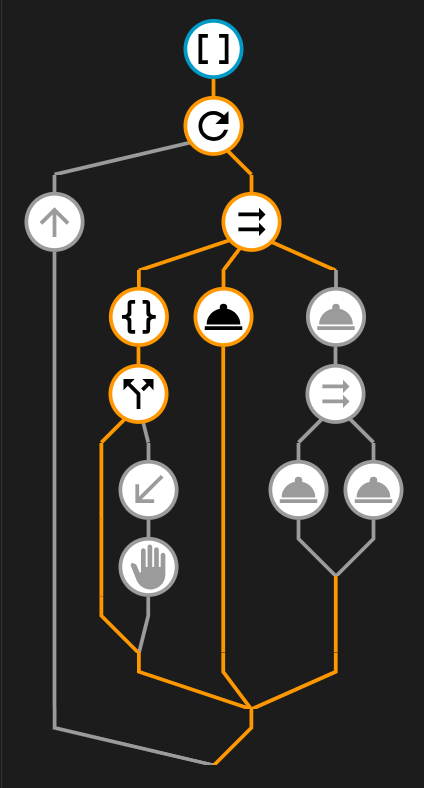

Adaptive (Daytime) Lighting Script
This script’s purpose is to change the lighting mode based on the value of my global light temperature and brightness helpers. Those get affected by the cloud coverage values in a separate Weather-based automation.
My purpose is changing the light color to match the color of light outside. It’s unimportant how those values get changed in this automation, only that it listens for changes in those values.

Sorry if I missed this above, but what sets those various datetime triggers? Are those set manually or based on another automation (trigger on sun position, for example).
Question:
triggers:
    domain: zha
    type: press
    subtype: Up
    trigger: device
I don’t use ZHA but if you go to that device are there entities for those events? Perhaps like this?
They might be under disabled entities. In my case that Scene 001 has the entity event.living_room_cans_scene_001.
Do you have those?
I can change this value, but I don’t. Although, I was thinking about changing the nighttime one because the sun is still up close to 9:00p now rather than going away at 4:30p in the winter.
ZHA is per device, and none or mostly none of mine have those scenes. I use smart lights too.
And not everything is ZHA. Many are Wi-Fi LIFX lights as well. It’s whatever works.
(You don’t need to quote everything, I can follow the context.)
You are not going to like my approach as it might feel like too much “code”, but maybe worth entertaining for now.
Remember one goal is to reduce/combine the number of automations and simplify the overall scripts and automations.
I’d first start by simplifying the triggers.
Your initial triggers list repeated device IDs (who knows what those are?) and if you combine those with other lights it just multiples as you noted before.
I was asking about the “event.” entities because it makes it a little easier to figure out what event happened and listen to only the ones you care about. You might have to watch the ZHA events and pull out the ones that link to devices you are interested in.
When I push a button on a z-wave scene controller I see something like this (trimmed)
event_type: zwave_js_value_notification
  device_id: 88767d293be4ada9d65a25aa33e732bb
  property_key: "001"
  value: KeyPressed
From I can figure out what happened on which device. So, with a tiny bit of mapping you can then figure out what needs to happen to which light.
End of day for me. Will be interesting to see what others come up with.
Have you considered using the sun integration with above_horizen or below_horizen with an offset? that way it adjusts to your local daylight hours. Some of my automations even use a light sensor value to determine this (I’m expanding)
Yes I just nested/double quoted.
I have actually. Someone was showing a video where he used an offset on the Sun. Never thought of doing that.
Sadly, there are a few places I have a hard cutoff at a specific time (kids bedroom, etc) where I disable occupancy sensing. I’d need to make sure those aren’t tied to the Nighttime Lighting helper. If so, then I can do this for sure!
Those are buttons:
I’ll update my original post with an image as well :+1:.
When I said “Your initial triggers list repeated device IDs (who knows what those are?)” that was a rhetorical question. Meaning when you look at the YAML and see “359bc5a5f510d587696d3042b560c8b7” that doesn’t really tell you “the bedroom hall light”. Sure the UI will map that for you as long as that id never changes.
And you you want some fun, remove that from ZHA and include it back in and see what happens to your triggers.
Not terribly robust, right?
@Sawtaytoes, is the answer to all these questions “yes”?
  • You want to simplify your multiple automations into maybe one or two and make it more scalable and (yeah) robust. For example, have a single automation that handles all the zha scene controllers and associated lights?
  • You are ok (maybe) separating out the daylight changes automation. This is because when that changes it impacts all lights that are currently on.

You can make a single main automation to call all your scripts with something like this:
alias: Control All zha lights
description: ""
mode: parallel
max: 25
trace:
  stored_traces: 25
triggers:
  - id: "Button"
    trigger: event
    event_type: zha_event
  - entity_id:
      ### LIST ALL ENTITY_IDs FOR MOTION DETECTION ###
    to: "on"
    trigger: state
  - entity_id:
    to: "off"
    trigger: state
    for:
      hours: 0
      minutes: 0
      seconds: 20
variables:
  config:
    #  Bedroom Hallway
    - motions:
      devices:
      - 359bc5a5f510d587696d3042b560c8b7
      multi_press_complete-3-2: Turn on Occupancy Sensing
      ### ADD OTHER ZHA COMBOS HERE DEPENDING ON DEVICE DIFFERENCES, MAP THEM TO YOUR SCRIPT INPUTS ###
      # OUTPUTS
      output:
        lights:
    # ADD ADDITIONAL CONFIG ITEMS AS A LISTED ITEM HERE
  zha_event: >
    {% if trigger.id == "Button" %}
      {# This may change depending on your event data. #}
      {{ trigger.event.data.command }}-{{ trigger.event.data.endpoint_id }}-{{ trigger.event.data.params.get('total_number_of_presses_counted', 'x') }}
    {% else %}
      None
    {% endif %}
  target_config: >
    {% if zha_event is None %}
      {{ config | selectattr('motions', 'contains', trigger.entity_id) | list | first | default({}) }}
    {% else %}
      {{ config | selectattr('devices', 'contains', trigger.event.data.device_id) | list | first | default({}) }}
    {% endif %}
  trigger_id: >
      Occupancy: Turn {{ trigger.to_state.state }} Lights
    {% elif target_config %}
      {% set event = target_config.get(zha_event) %}
      {{ "Button: " ~ event if event is not none else None }}
    {% else %}
      None
    {% endif %}
conditions:
  value_template: "{{ trigger_id is not None }}"
actions:
  - action: script.control_button_occupancy_day_night_lights
    data: >
      {{ dict(trigger_id=trigger_id, **target_config.output) }}
Understand this automation will be firing a lot.
You will need to make your script script.control_button_occupancy_day_night_lights parallel if it isn’t already.
The benefit of going this route is that everything from the zha_event variable and below never needs modifying. You only need to add items to the config. I added comments with how to manage it.
The take away here is that it will handle all zha events without needing to modify anything but the config and the entity_id’s in the occupancy triggers. When you add a new area, you just add a config and the occupancy entity_ids.
Your button configs will require you to watch zha_events in the event viewer and populate the information. Because you haven’t provided examples, I went off previous posts of yours for the one example I saw, which was in this post.
Your inovelli option in the config would be a zha combo button_2_double-3-x, where the x is in place of the number of presses which differs from the ikea events.
Lastly, if you need different for durations, that would just be separate triggers but you can bundle binary sensors with like durations. Just make sure to keep the trigger id as id: Occupancy.
Or not bother calling scripts. The scripts are light.turn_(on|off), which can be a single action.
Push a button and turn a light on or off. As things go, you add a few more triggers – like motion or day/night change and now you have an automation for each. Do that for a few rooms and things multiply – which was what the original post was about.
The scripts are not really making things simpler. As the OP pointed out, combine triggers and use trigger ID, and then use groups, labels (or config) to avoid duplicating for each room.
Is there a reason why passing a list of device id should not be possible using trigger variables? That would help a lot.
