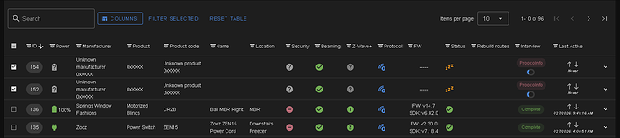

The remote has an LCD screen and menu, and I followed the instructions to include (ZWave > Learn), and the menu changes to “Joining”, and I can see a new “unknown Product” device in my ZWave UI, but it is indefinitely stuck on “ProtocolInfo”. I’ve tried it multiple times, using Default Security, No Security, and “Resending” the inclusion from the remote, or simply pressing a key, just to keep it awake. If I don’t, ZWave comes back and tells me no devices were found and times out. I can keep it alive for as long as I want and ZWave will just keep spinning, never timing out, but never getting past “ProtocolInfo” either. Every time I try it, I get a new Unknown Product Node, still spinning, with a new node number. That last shade I added was note 136 (my last) on my network, and I’m up to 154 now trying to add this remote back.

Here is a screenshot of the ZWUI following two attempts. This will remain until I delete them.
