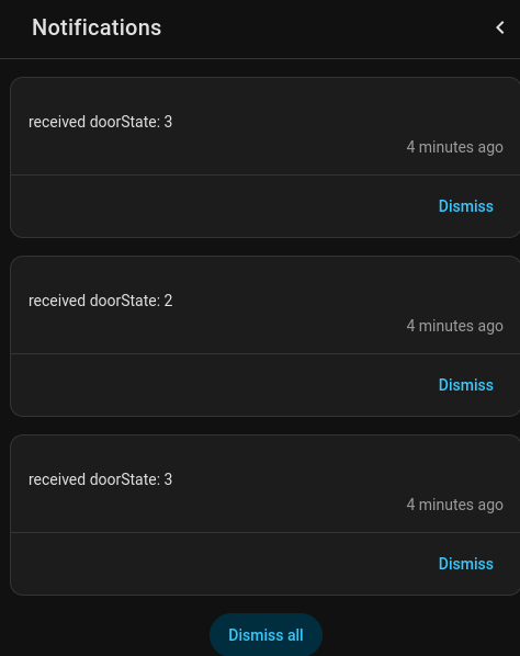

As suspected, tedee bridge is sending the correct data (this is close, open, close on door sensor):
source for the screenshot above:
- alias: "Debug webhook data"
  trigger:
    - platform: webhook
      webhook_id: XXXXXXXXXXXXXXXXX
  action:
    - service: persistent_notification.create
        message: "received doorState: {{ trigger.json.data.doorState }}"
