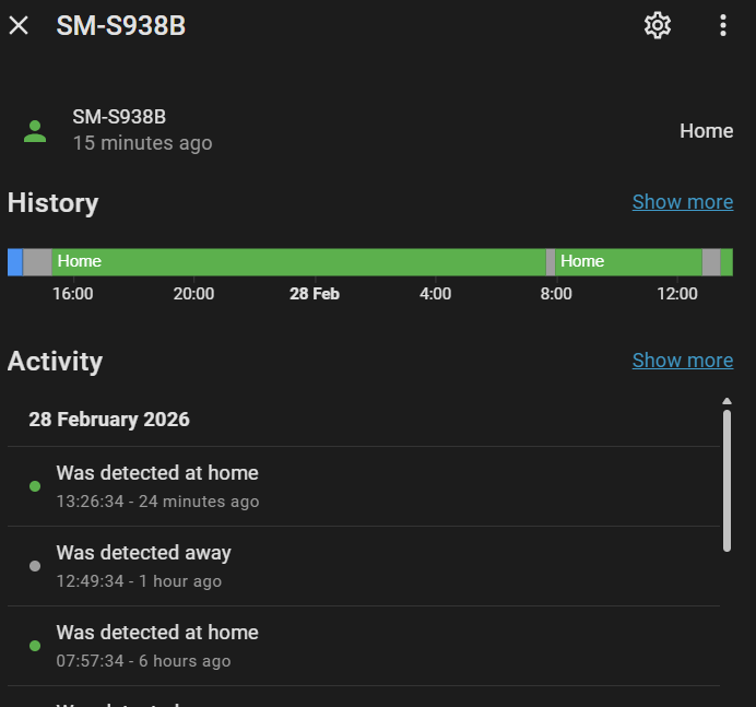

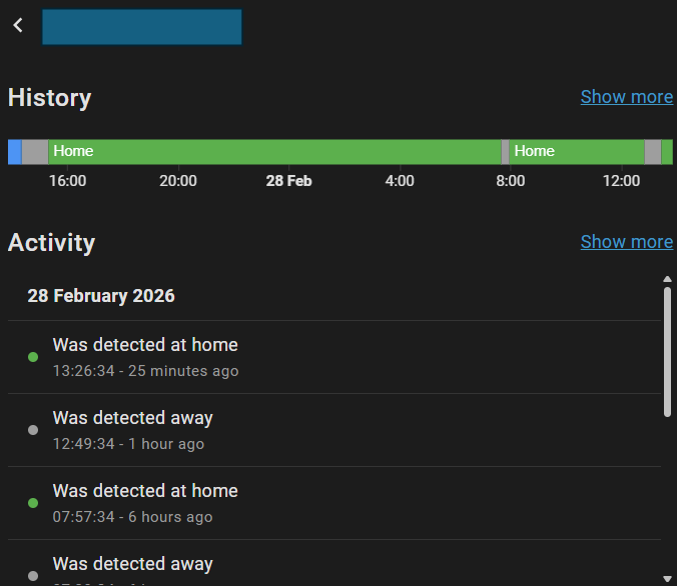

FWIW confirmation that both the device_tracker and person sensors are functioning appropriately:
Device tracker:
Person:
