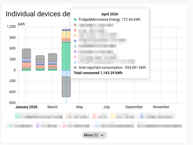

I track my electricity consumption since last year at least, and I check the historical statistics every now on then. Last time I did that, I noticed something is off in April. My fridge and my microwave are supposed to have consumed 800 kWh instead of 40 kWh usually. This breaks the yearly statistics.
I don’t know what the cause is. Is there a way to fix or remove the bad data?

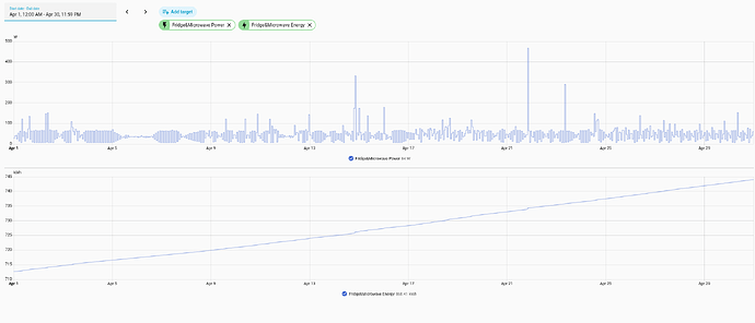

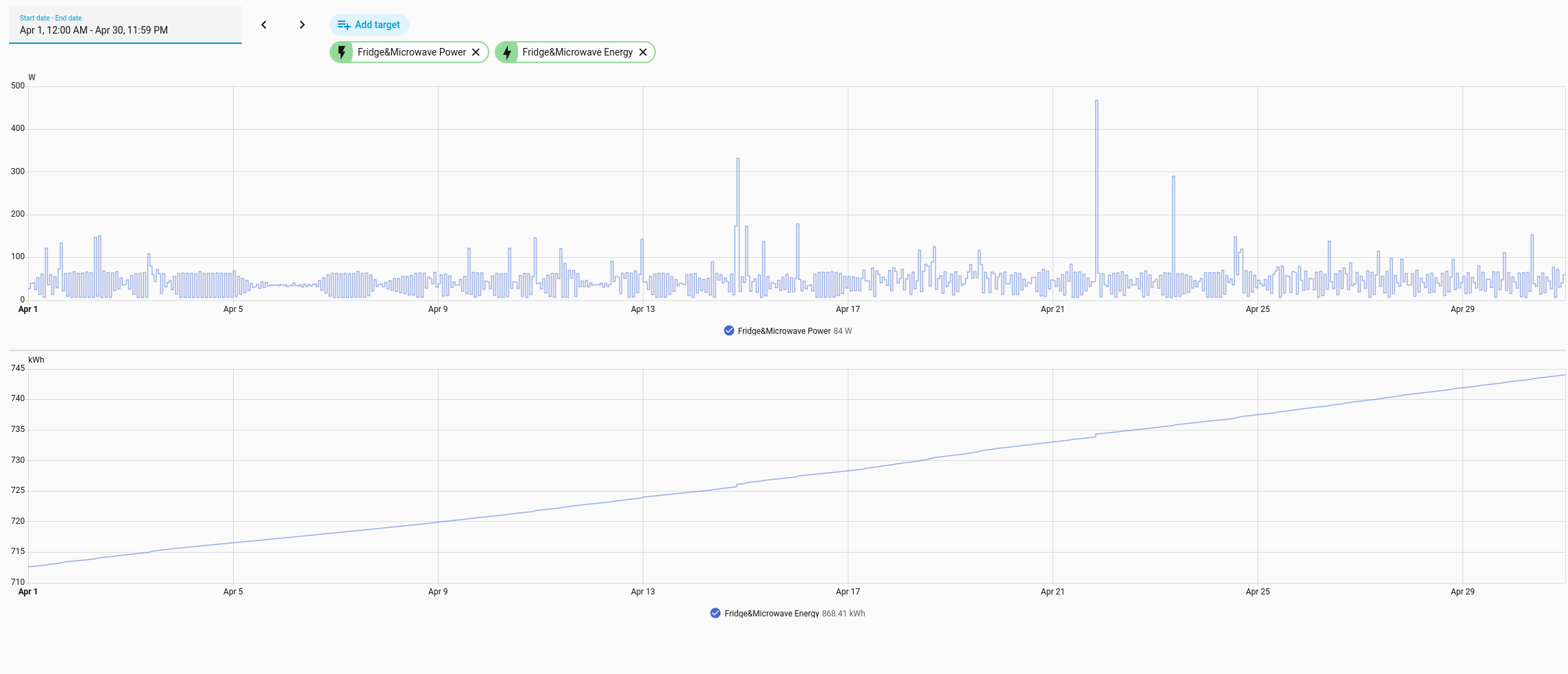

Thank you @tom_l for the quick reply. I tried it out, but data of the sensor looks fine for March, April and May:
So the glitch must come from somewhere else.
