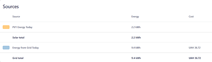

Hi everyone. I’m having an issue with the Energy Dashboard. It’s not showing the correct energy cost calculation.

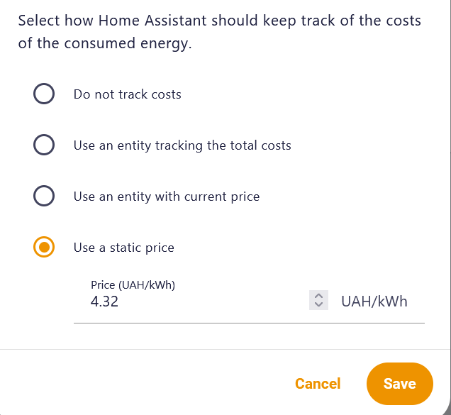

I set a fixed electricity price of 4.32, and as you can see in the screenshot below, the energy consumption for October 26th is 9.4 kWh, which seems correct. However, the reported energy cost is 36.72, which doesn’t add up since 9.4 × 4.32 = 40.61, not 36.72.
Am I missing something, or could this be a bug?

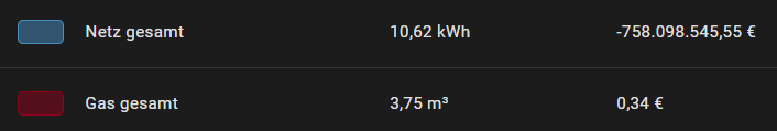

Seems to be a bug. My calculations are extremely incorrect after only half a day, but only for the electricity price; the gas price is calculated mathematically correctly.
I am using the fixed price option.
Just out of curiosity, does you pic means, you’ve paid less than 1 Euro for 3,75 cubic Gas ?
