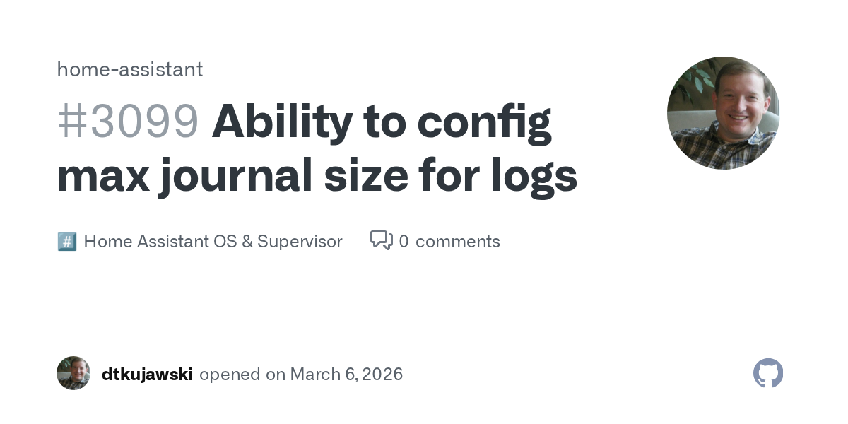

Seems like there is no way that I can find to do this which survives a reboot of the HAOS. I’ve tried mounting overlays and that works, but only until the next reboot. This is something that was changed in 2023 or so (based on GIT commit history)
As such, I’ve submitted a feature request:
