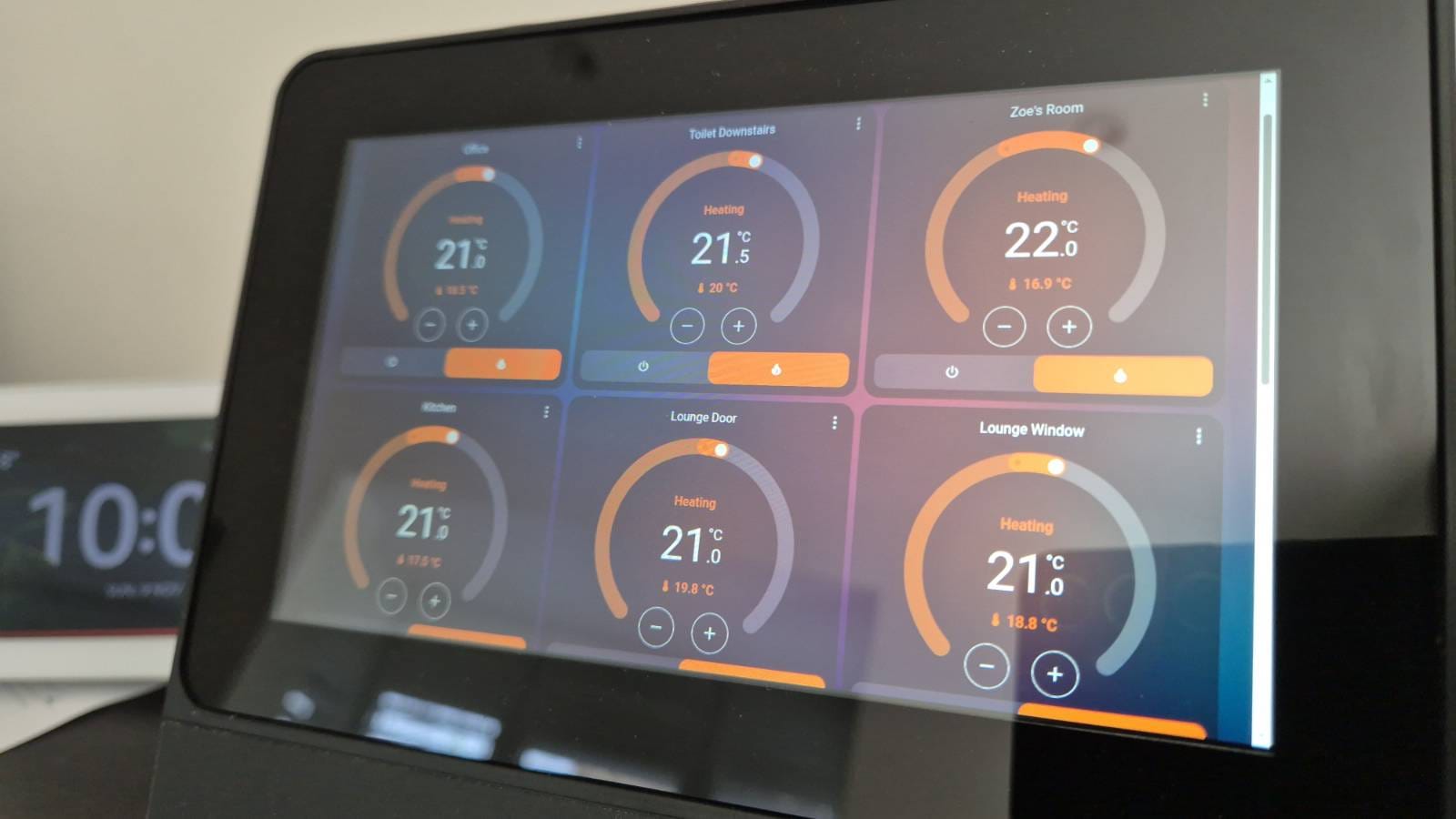

Running a touchscreen kiosk with chromium browser powered by a dedicated RPi4. Have nice looking thermostats on the touchscreen to control my radiators… but the scroll bar is way too thin for my fat fingers!

Any additional suggestions from clever folk than me please!? It seems there’s all manner of – switches and parameters that Chromium allows to modify (colour, shades etc) but nothing about width.
