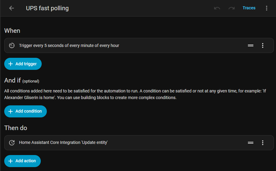

Turn off auto polling and use an automation to poll manually :thinking:
That’ll do!
What trigger did you use for the polling automation?

That’s the automation, very simple:

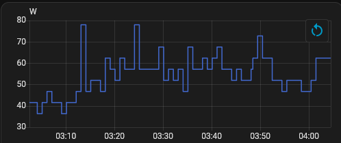

A 5s polling interval is plenty for a “responsive” display. I don’t see any CPU spikes or adverse effects, but I also have everything running on an i5 10th gen with 32GB RAM (Proxmox with NUT directly running on the host [:astonished:] and HA in a VM), so that kind of “load” is background noise.
Also-also, the 5s polling only updates 6 important sensor values (online/offline status, voltage, load percentage, power, battery runtime, battery charge). NUT provides a bunch of other data (battery capacity, type and whatnot) which is not time-critical, so for that I have another automation which polls every 30 seconds.
