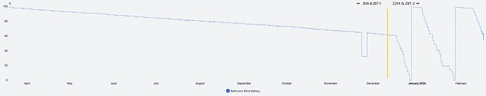

A few months back I swapped from using ZHA & ZBT-1 to zigbee2mqtt & ZBT-2 and I’ve noticed a large increase in battery use, particularly with one specific device - an IKEA Praktlysing Blind. Prior to the swap over the battery was lasting roughly a year - since the swapover, it’s now lasting only 1 month. Here’s the battery history:
Swapped over to ZBT-2 and Z2M in mid-December (yellow-line I added on graph), and as you can see, since then the battery life has been terrible.

I've noticed that too. In my case, only the Eurotronics thermostats are affected. Or rather, after two months, those are the only ones I've been able to identify so far.
before: zha + conbee2 = 1y battery life
now: zha + zbt-2 = lithium energizer I bought one month before upgrading, all died after one month zbt-2 usage. then I think the expensive lithium are faulty and i switched to the Duracell 200%. after 2 weeks they are all between 20%-60%.
nothing changed after upgrade and winter is over. The thermostats don't have much to do.
I can't keep changing the batteries in four thermostats every few weeks. It's getting expensive and annoying.
