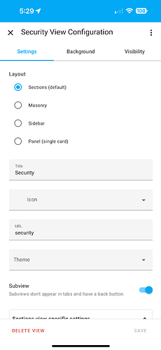

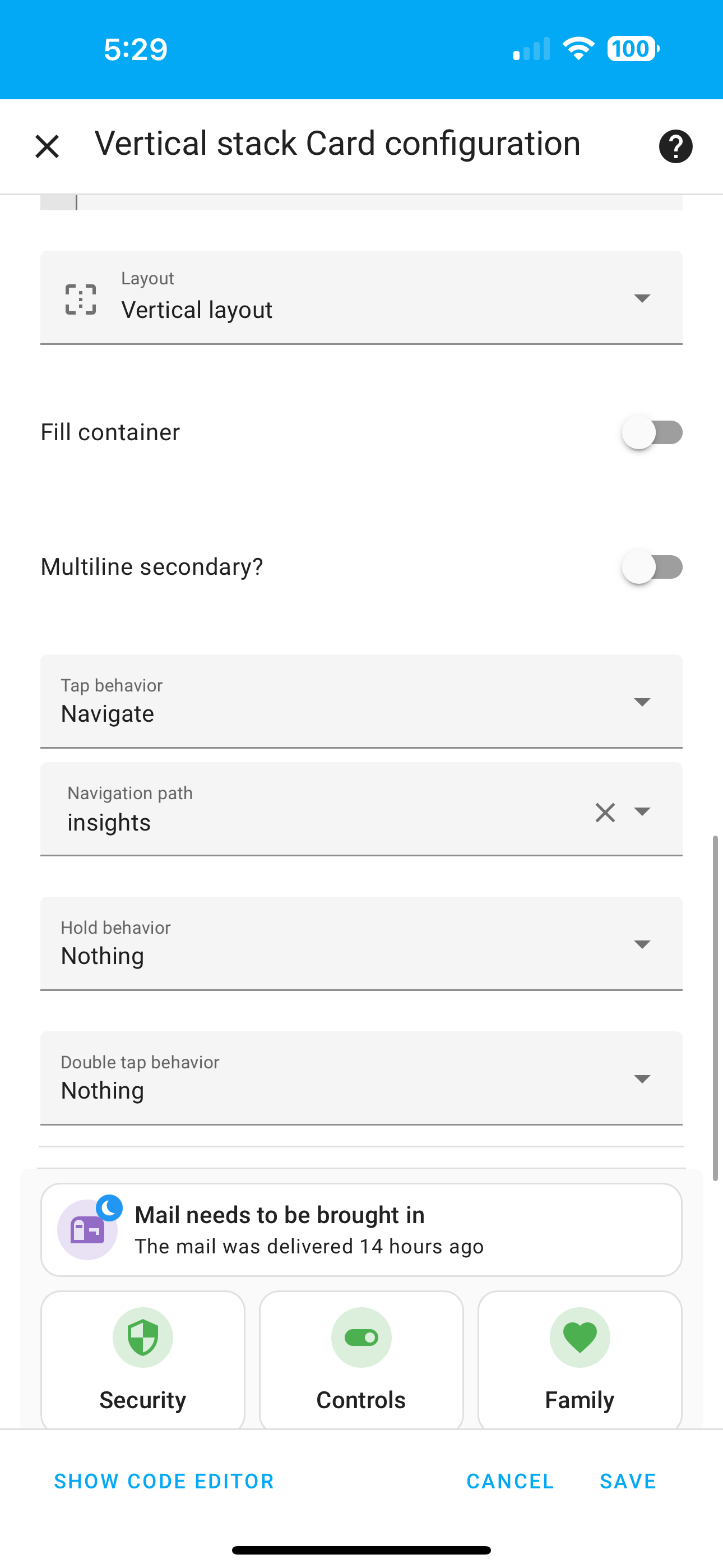

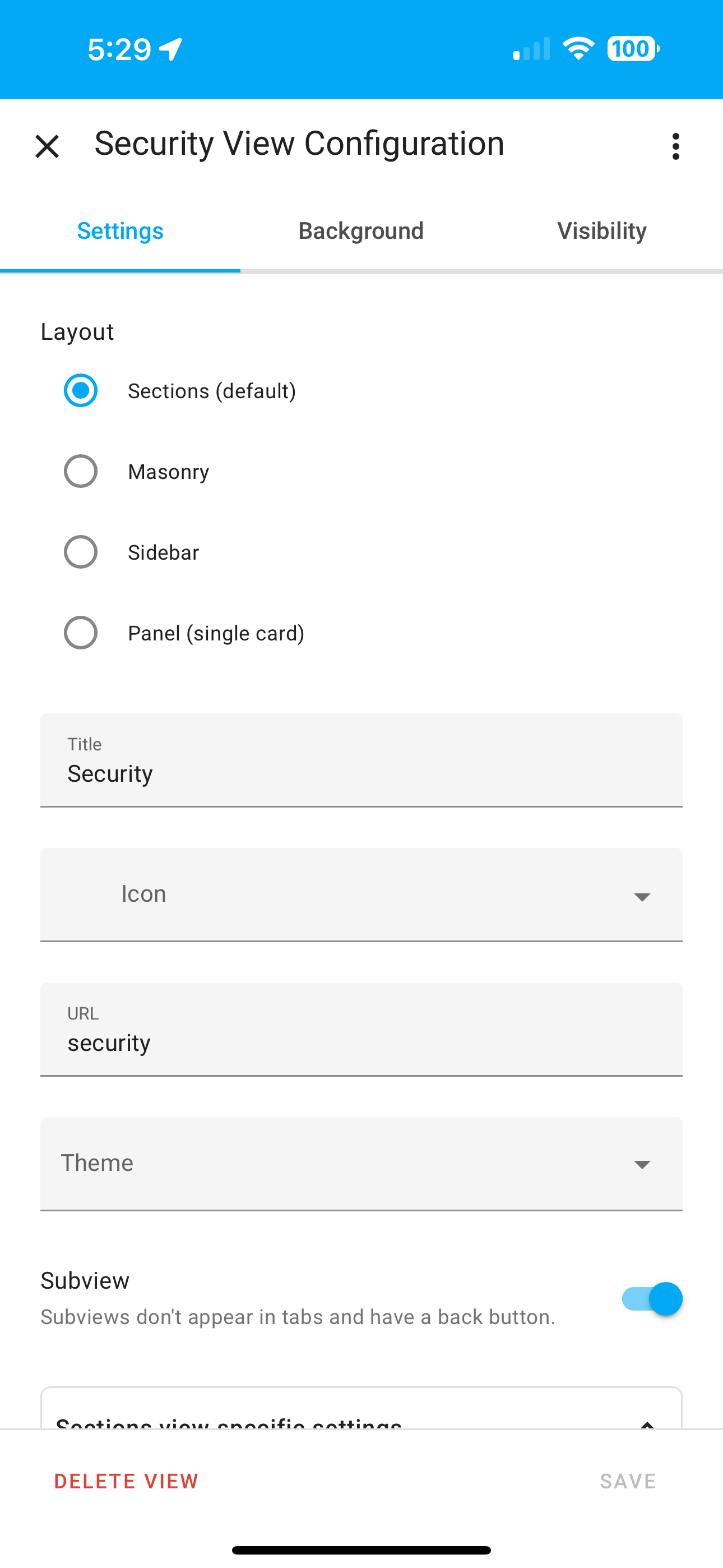

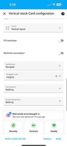

Hi @Wuffls. What I do is create a card on the main view (“home” or something) that has a “tap_action” of “navigate”. The value would be whatever string you setup on the new subview.
Then you can click that card or chip or whatever on the main view, and you’ll be taken to the subview.
By the way, make sure to mark the new view as a “subview”. This puts a “back” button for you automatically, to get back to the main view.
Here’s a couple screenshots.
Matt
