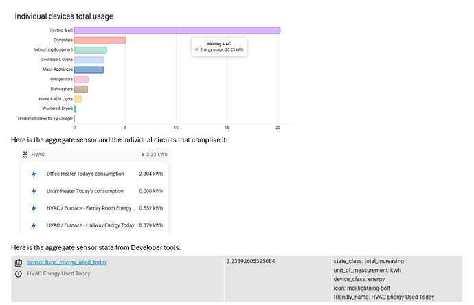

I am using an Emporia Vue to monitor a number of my circuits, and created a template sensor to aggregate them into categories. I have have confirmed that the aggregate template sensor correctly adds the individual values, but when I add these aggregated sensors to the built individual devices detail usage graph in the built-in Energy Dashboard, the values are way off (>5 times higher than expected.) I have confirmed the device class, units of measure and state class are the same as the individual circuit sensors being measured. Here is an example - I have a group called Heating & AC and on the Energy Dashboard it is showing up as 20.2 kWh, but it should be 3.2 kWh:
You can’t simply sum total_increasing sensors that reset into another total_increasing sensor, it messes with the reset logic.
If you must sum energy sensors with a template, try to sum non-resetting sensors only. If any of them ever go back to 0 or decrease, it will wreck the total sensor.

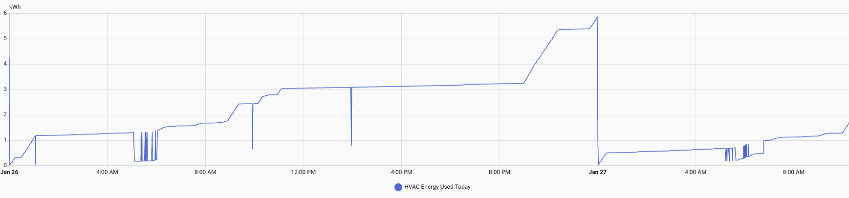

Can you please share a screenshot of the history of this sensor. Use the History panel in the side menu, not the pop-up more info card.

@tom_l - screen show below. This is from the start of Jan 26 to today:
Yeah you can clearly see what karwosts is talking about in that graph.
Every time the energy surges upward at all those spikes it adds the energy amount equivalent to the height of the spike. The downward movement does nothing to the total, only upward.
