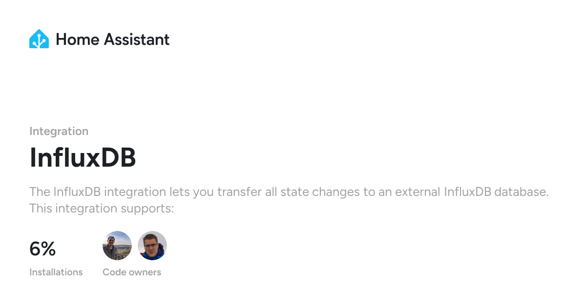

The influxdb integration can use core V3, but not the add-on AFAIK…

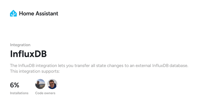

The Influxdb App (Add-on) only supports influx 1.8.
It likely won’t do what you want it to.
Use the integration.
