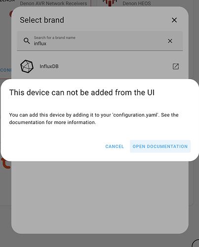

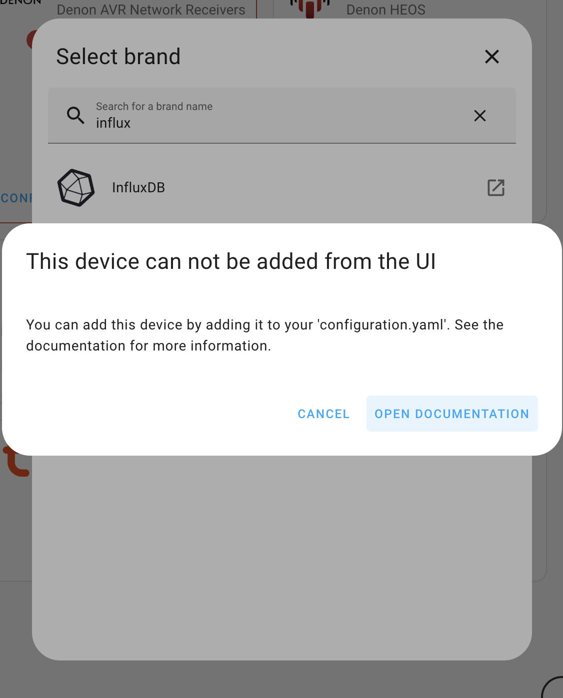

When I try to add it via the UI. I get this message:
Are we expecting it to be configurable via the UI?
I see you are correct. That takes you to the Docs, so follow the instructions there. I have not used this, so I don’t know more than this.
