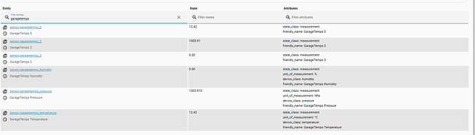

I have a screen of the following where I have modified an OpenESP32 sensor to “work around” the issue:
You are able to see the top 3 entities: “sensor.garagetemps_0, sensor.garagetemps_2 and sensor.garagetemps_3”. These values which are your pressure, temp and humidity get written to influx however the same measurements below (pressure, temperature etc) do not get written to influx. They have a device class and unit of measurement set and are totally ignored by the integration where as the 3 sensors.
OpenESP32 it allows me this flexibility to basically change this value to something the integration will accept , tasmota sensors and ESPhome sensors dont allow me this flexibility so thus arent accepted for to be written yet do display in home assistant itself.
