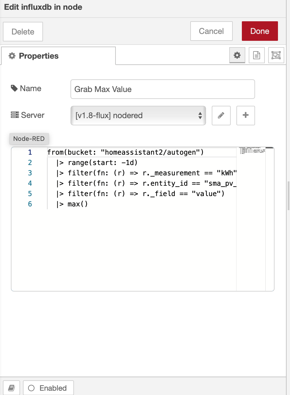

The attached image shows how I set up the node. This gives me one value in an array that is the maximum over the previous 24 hours. My solar monitor produces an increasing value for the total output up until about 8pm, then is zeroes it out. So when I run this at 11pm, I get all the values from 11pm the previous day. The max will be the total for “today”. A bit crude, but it does what I want it to do.
