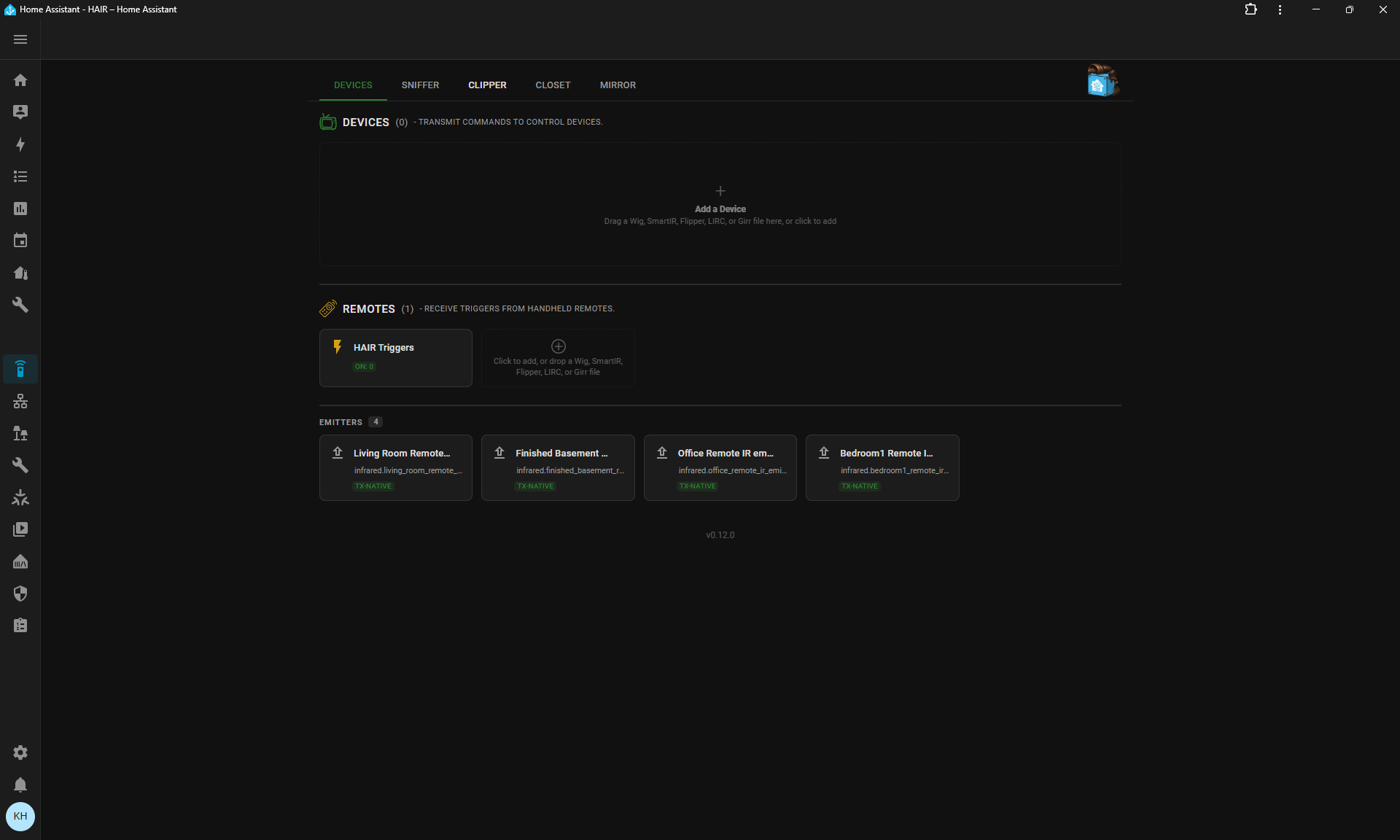

I did not see where Pluck was an option in HAIR or any … option.
If I were to get an ESP32 module, what do you recommend?
