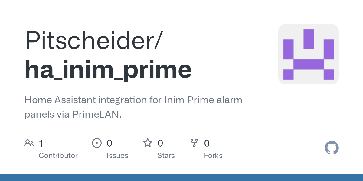

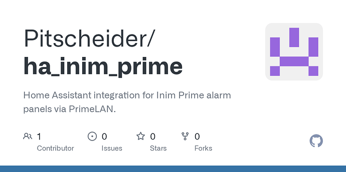

Hi everyone,
following up on the recent post about the INIM Cloud–based integration, I’d like to share a different but complementary approach I’ve been working on for a while.
I’ve developed a local Home Assistant integration for INIM Prime alarm panels, which communicates directly with the panel over LAN via PrimeLAN, using the official local Web API (no cloud involved).
:link: GitHub repository:
Key differences
  • Local communication (no Internet / no INIM Cloud)
  • Works only with Prime panels
  • Requires PrimeLAN network card
Current features
The integration currently allows you to:
  • Monitor panel, GSM, zones and partitions
  • Read zone states, alarm memories and diagnostics
  • Track event logs from the panel
  • Exclude/include zones
  • Set partition modes (disarmed, instant, partial, total)
  • Clear alarm memories
It is installable via HACS, and the repository includes detailed documentation covering:
  • Prime/STUDIO configuration
  • PrimeLAN & Web API setup
  • Home Assistant installation and usage
Limitations & future work
This is my first Home Assistant integration, and it should be considered experimental.
Some features (notably scenarios and outputs) are not currently supported due to limitations or issues in firmware 4.07 (at least on my panel).
I’d love feedback from anyone willing to try it out — bug reports, suggestions and constructive criticism are more than welcome.
:warning: Important notes
  • Community-developed, not affiliated with INIM Electronics
  • Active development, breaking changes may occur
  • Not all panel features are supported
  • Do not rely on it as the sole security/control system
  • LAN-only usage recommended (PrimeLAN uses outdated TLS)
Thanks, and I’m happy to answer any technical questions :slightly_smiling_face:

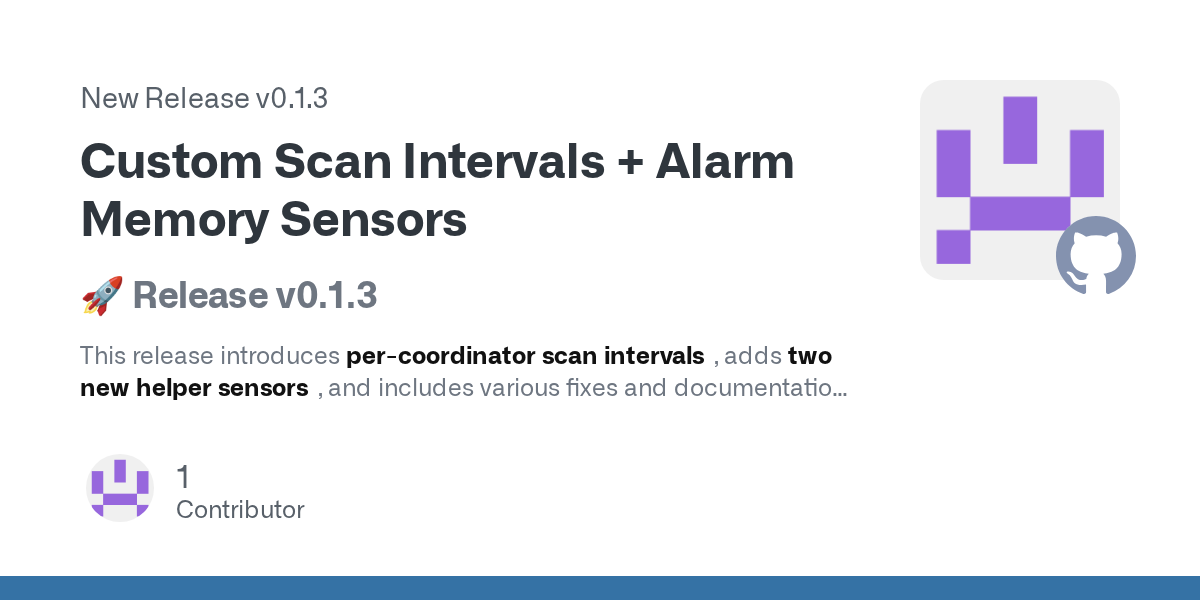

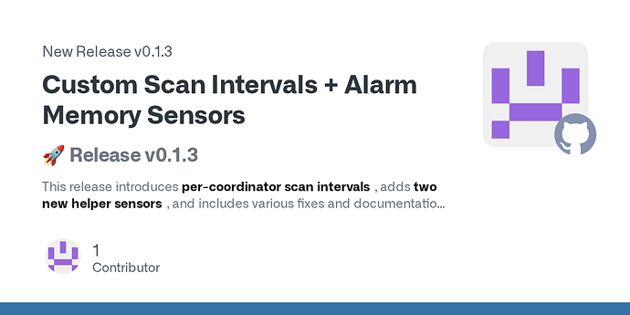

I’ve now released v0.1.3, and it includes exactly what I mentioned earlier — custom scan intervals with per-coordinator control (Zones, Partitions, GSM, System Faults, and Panel Log Events).
So you can now fine-tune how often Home Assistant polls the panel depending on the type of data you care about most.
With the new default values, for instance, zones responsiveness is significantly better.
Release notes here:
Let me know if you have any feedback or ideas for further improvements!
