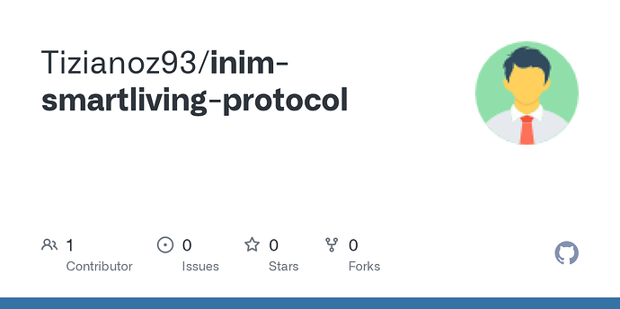

Guys, after a few days of work, I’ve successfully reverse-engineered the INIM SmartLiving TCP protocol.
I’ve also developed a fully functional Home Assistant integration (currently in early alpha).
If you’re interested, feel free to DM me.
This version supports all SmartLiving models and firmware versions, and works with both SmartLAN/G and SmartLAN/SI modules.
