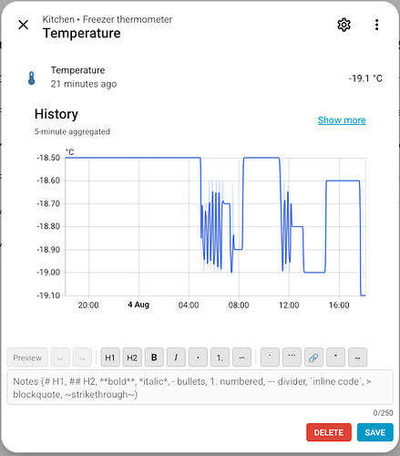

Anyone use Inkbird IBS-TH2 temperature sensors with Bluetooth proxies?
The problem is that sometimes they update every few minutes and sometimes not for hours. No errors.
This particular one is in the freezer, but I have a couple of others not in cold metal boxes showing similar behaviour.
The proxies are there mainly for room tracking using the Bermuda integration, which is working perfectly. All are set to active.
I notice that the Passive BLE monitor integration from HACS specifically doesn’t work with proxies . Does this apply to Inkbird as well? Hard to see why the sensors would sometimes work.

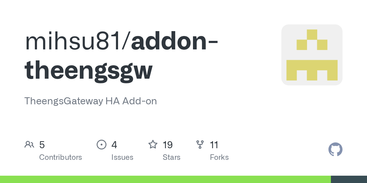

You might try the Theengs Gateway app instead of the Inkbird integration - I’m getting better results with that.
TheengsGateway HA Add-on
