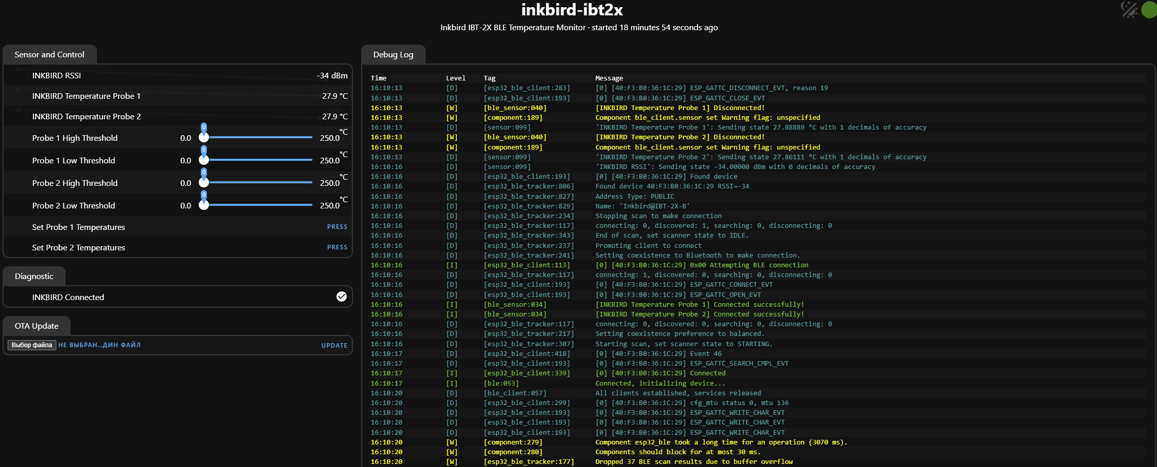

Since I still not good in Code, I used AI to found services and connect it throughout ESPHOME

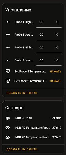

number:
  - platform: template
    name: "Probe 1 Low Threshold"
    min_value: 0
    max_value: 250
    step: 0.5
    unit_of_measurement: "°C"
    optimistic: true
    name: "Probe 1 High Threshold"
    min_value: 0
    max_value: 250
    step: 0.5
    optimistic: true
    name: "Probe 2 Low Threshold"
    min_value: 0
    max_value: 250
    step: 0.5
    optimistic: true
    name: "Probe 2 High Threshold"
    min_value: 0
    max_value: 250
    step: 0.5
    optimistic: true

button:
    name: "Set Probe 1 Temperatures"
    on_press:
      then:
        - script.execute: set_target_temps_probe1
    name: "Set Probe 2 Temperatures"
    on_press:
      then:
        - script.execute: set_target_temps_probe2
Hope it will be supported soon.
