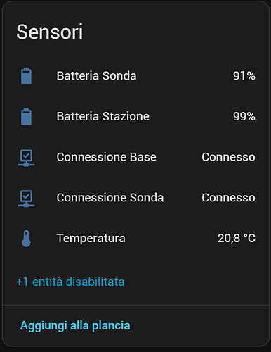

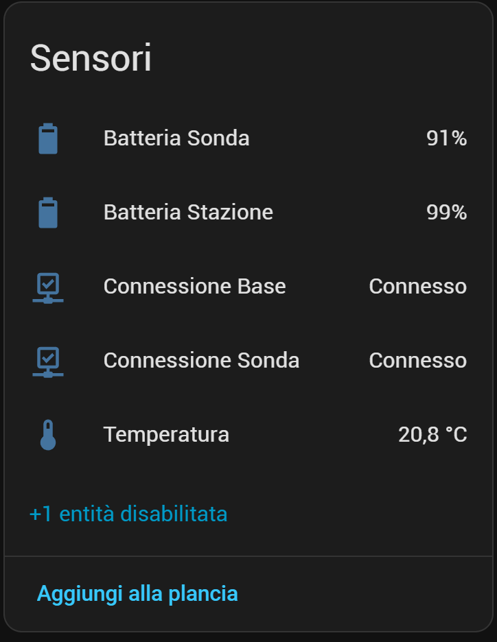

Inkbird INT-11I-B thermometer integration for ESPHome
For anyone who needs to integrate this thermometer model, I was able to extract some data: the probe temperature, along with the battery charge level of both the probe and the booster.
You only need to change the MAC address value to that of your device.
VERY IMPORTANT!
Set an initial recipe on your device through the official app. Without this setting, the booster turns off after 10 minutes.
###   This is a package related to the Inkbird INT-11I-B thermometer.
###   The code acquires the probe temperature data and the battery status (for both the booster and the probe).
###   It also provides the connection status of the probe and the booster.
###   Replace the MAC address with that of your own device.
###   VERY IMPORTANT! Set an initial recipe on your device through the official app. Without this setting, the booster turns off after 10 minutes.
