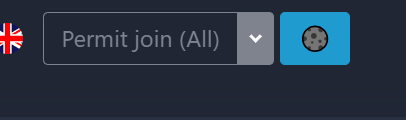

You didn’t need to do any of that. Permit Join button in Z2M has an arrow next to it:

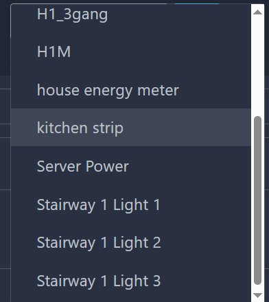

Click that, and you should see all router devices:
Select the closest Third Reality switch to your Inovelli, and it should pair via that router.
