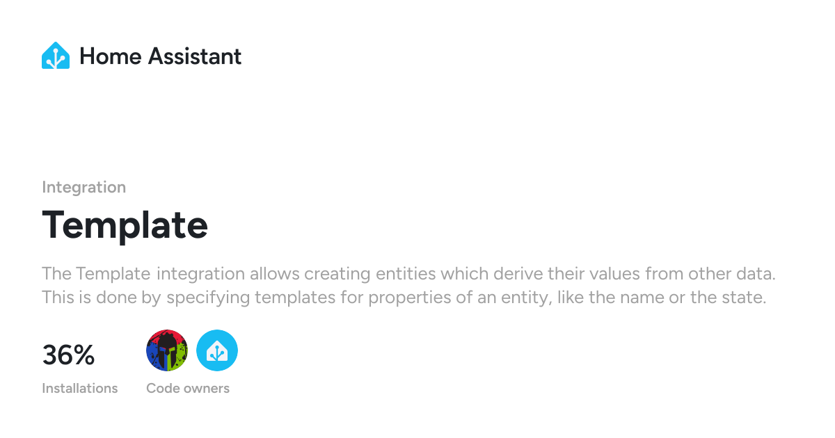

This looks like exactly what the OP is asking for.
You basically have 4 options:
  1. Use a “Template Helper Switch” - Which exposes some other entity / logic as a switch (doesn’t store state itself).
  2. Use a blueprint written by someone else - which likely just wraps a THS.
  3. Use an MQTT switch with both the state and command topic set to the same value - this effectively looks and works like an input helper toggle, but is actually a switch.
  4. Use a third party plugin (some people have created them) which registers as a switch.
I have only ever used options #1 and #3.

tom_l Already posted a direct link to the documentation for it:

Yu send me the link for the Templates, saw that - but i asked yopu about a example snip code
That code is total different… that code swtichs a switch through a binary sensor
I need a switch single
