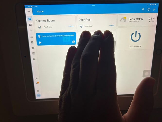

I’m trying to setup a one-tap “Plex Server Off” button in Home Assistant for an Ubuntu Plex Server. Wake on LAN works perfectly via the normal WOL integrations section in HA;, the shutdown side is what I’m stuck on. I’m trying to setup a HA dashboard button that, when pressed, SSHes into the Ubuntu server and runs shutdown -h now, so the machine doesn’t get left running for days.

When I press the dashboard button (pictured), nothing happens - the plex server doesn’t shut down. Pressing it multiple times has no effect. The Wake-on-LAN command works perfectly fine from the same dashboard so its not a connectivity issue. Appreciate any guidance, thank you in advance.
